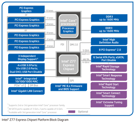

We have now come full circle and I feel more confident that your northbridge needs more voltage. Be careful with adjusting your settings. Think everything through carefully so you do not put too much voltage through the system. If necessary, drop your cpu overclock a bit if your voltages are too high.
Further searching shows the Intel Z77 chipset does not have a northbridge. The video is directly connected to the cpu. I have not kept up with Intel advancements so missed this. Is there a voltage setting you can use for video signal communication? Possibly a PCI-E video voltage setting.

PCH Voltage
Intel Z77 'Panther Point' Chipset Overview
Today's chipsets are merely responsible for I/O and have little bearing on performance. In fact, they're not even really a "chipset" anymore as there isn't a set of chips. Years ago, it was common for chipsets to have a northbridge and southbridge. The former was the direct line of communication between the CPU, GPU and memory, while the latter handled everything else from expansion slots to storage.
However, as features such as the memory controller were moved from the northbridge to the CPU itself, the chip played less of a role. Eventually, Intel took what was left of the northbridge and added it to the southbridge in what the company calls a PCH or Platform Controller Hub.
Therefore, we should not need to adjust the PCH voltage.
