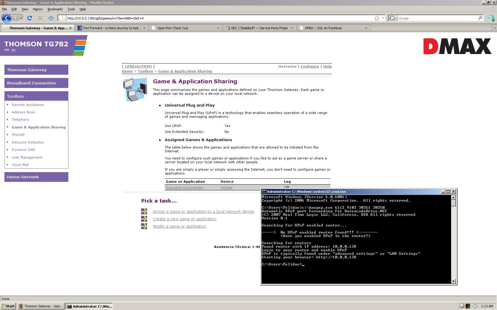

omg... no ports at all.. I need 6112 9103 30350 30351 to my computer forwarded to play some strategy games... thx strategy designers for the peer to peer funcionality... anyway... those ports are needed and after i set them up in the router... and also direct them to my computer... I am like... what the %^&* they still closed in the tests... or stealth... and the game doesnt work.... even the ISP try to config them... but nothing is working... and network discovery is on.. and also filesharing in the network settings.. dunno what is... the trouble... all firewalls down... (dont hack me ok)!!! and no ports are reported forwarded to my comptuer....RRRRRRRRRR

OK.. mind if I ask why the baupnp.exe doesnt detect the router as upnp... when the router in the settings is set up to enable UPNP????
