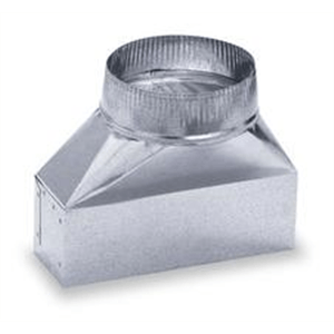

Look for square to round transition pieces... such as:
That's a typical household one (you'll probably find one in your house for floor vents, or kitchen exhaust)... not big enough since it's only 3.25" by 10" (6" pipe)
You *might* be able to find a 4.5" x 10" (7" pipe) if you have an actual HVAC place, which would probably be the closest one you'll find (unless you wanna pay for a custom one)... obviously 7" pipe is a bit much, and also not a typical size, so you'd have to reduce it to 6" easy enough with a pair of tin snips or scissors you don't plan on using again...lol
You can get 5x10" too, break into a school or office, you might find some...lol
Naturally you could make a 3.25x10" work too, cut it at the corners, and "fan" it out to 120 or 140mm... but you then you have to re-seal it again which would be a bit ugly.
