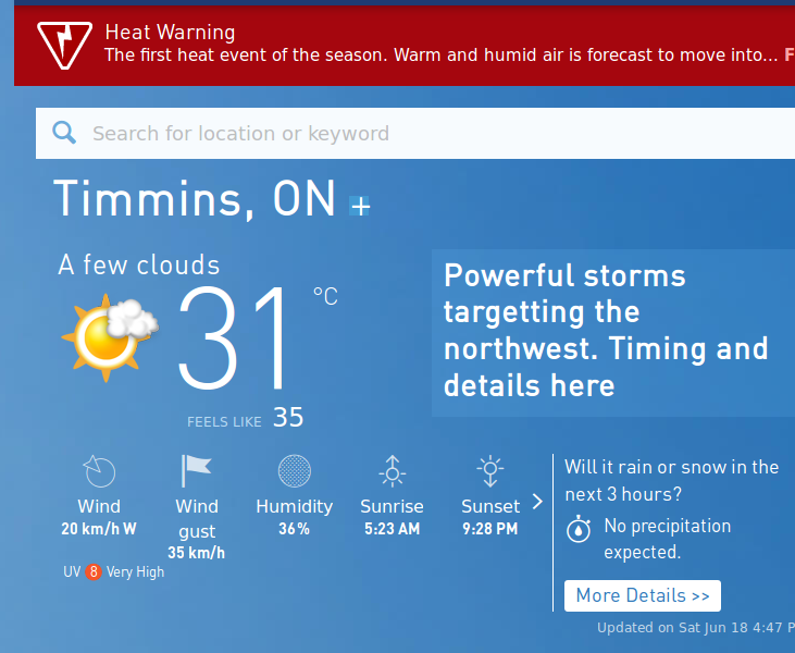

While it's short lived we do get heat waves, and it nice to have even just for those time periods so you can sleep better. This was the weekend:
That's fairly abnormal though. But even a straight week of +25's the house starts to get pretty hot.
It took me a while to decide to get cental AC though, as our summers are getting shorter so it feels almost not worth it, but this last heat wave it would have been nice to have.

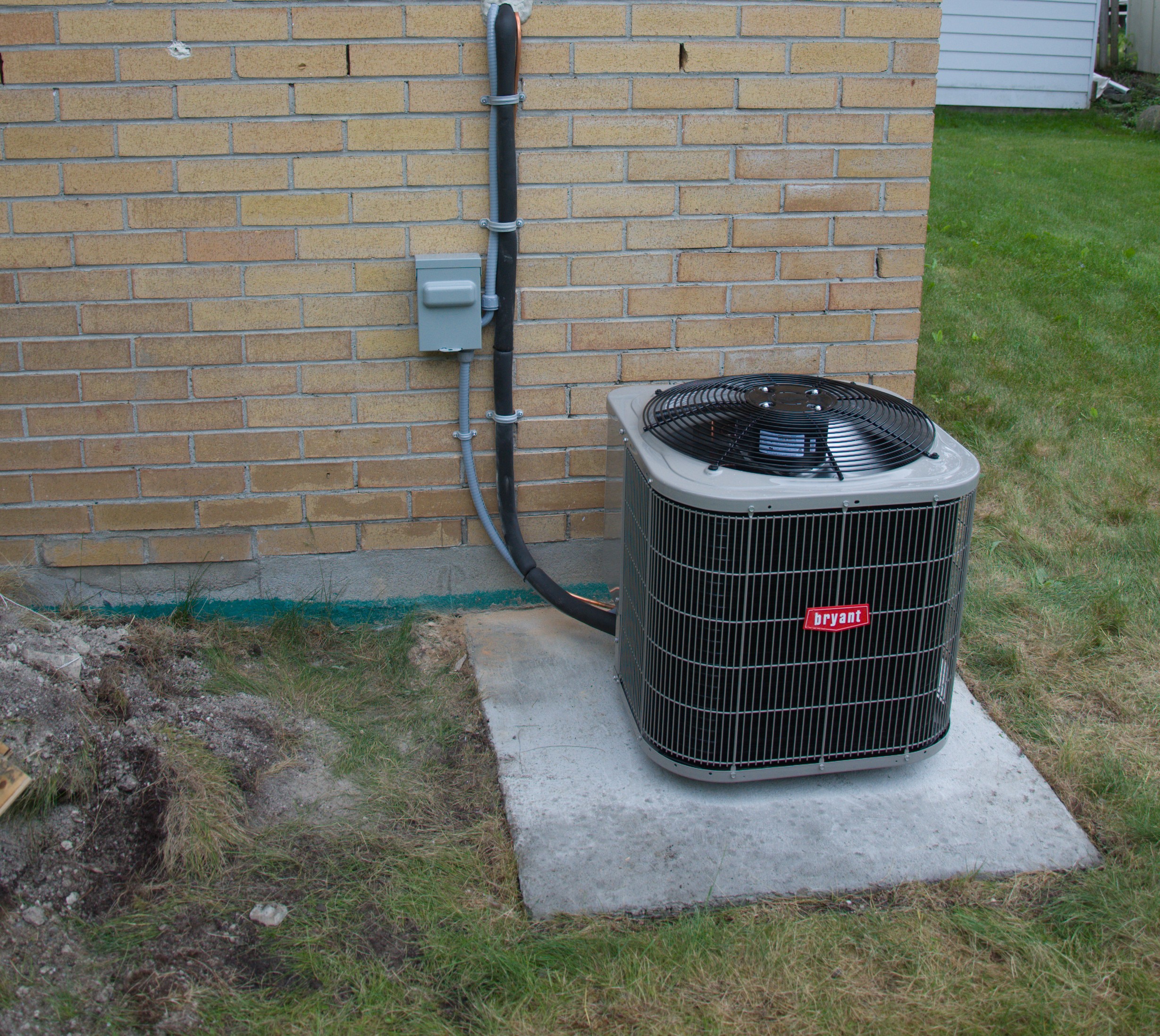

Well I bit the bullet, went with the Bryant one and they're coming on the 8th, going to pour a small cement pad soon and get the area ready. We finally got to see our new union agreement at work and will be signing soon, we actually get a raise this time so we will get it retro for over a year, and we have a signing bonus, so that money will help pay for this.
Read up on the Bryant one and it is considered one of their lower end models but it still had decent reviews, and the Payne one seemed like it was... a pain. :p Did not know they were made by Carrier though, that's normally considered a good brand. The sound it makes does not really matter to me, since the unit is outside, I will only hear the furnace blower inside. Most residential outside units I've seen are fairly loud.
