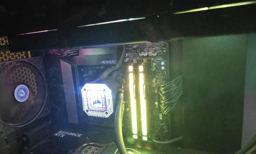

Are the fans oriented so they are pushing air through the rad? Is there any gap between the fans and rad? Is it resonance from vibration or air flow? It shouldn't be vibration on those fans, they are pretty expensive. Maybe one of them is faulty? Can you try and isolate each fan to see if it is one fan or a combination of the three?
hurricane501
Dec 18, 2017
17
The gap is tiny, see pic, so i dunno what i can do to
The 4090 doesnt even turn on half the time and the fans are dead silent on that thing, its 100% these 3 fans at the top, they have rubber around each screw and you can see the rubber touching the rad at the corners of each fan, so why does it have resonance?

Corsair RMA are useless they will just replace parts but thats not the issue the issue is how the parts connect.
Ive already had to throttle the pump as the pump is the worst noise ever! like a squealing pig, i will never ever buy another corsair AIO cooler.
Hopefully new mobo designs allow the CPU and heatsink on the rear and everything else on the front and then id just whack a huge air cooler on it... but with a 4090 i need the space as its too big.
hurricane501
Dec 18, 2017
17
And I said have you tried disconnecting one of those fans at a time to see if it's 1 bad fan. Who's the one that can't read?
Mate i dunno if youre not understanding something?
I can set every single fan to turn off... one by one... to pin point the exact issue.
SO i turned ALL the fans off then i turned them on one at a time so all off 1 on then all off 2 on all the way through the 6 fans to see if the issue was a unique fan.
I then turned on 1-3 which are the front case fans, = no issue so from there i knew the issue was 4-6 the rad fans at the top of the case.
I then turned off 4-6 and did the same again 4 on 5-6 off ect...
Doesnt matter which 4-6 fan is on it will resonate, its not a unique fan issue its any movement from any 4-6 fan on the rad and i get the resonating sound, obviously the more moving parts the worse the resonating too.
So what were trying to do is work out how to stop this, the idea above is very risky as anything not connected and secure properly could drop the rad on my 4090 which is basically the PC... cost over 50% the PC cost so i dont wanna risk trying to float the rad or anything if theres a chance of it coming loose and splatting my 4090.
Hope this makes sense to you as theres no need for me to disconnect anything, i can do everything via software.
StefanR5R
Dec 10, 2016
6,858
11,043
The noise is a hum resonance sound from the case
Two things to try then:
a) As mentioned, try to identify which part of the case (if any) is resonating, by pressing hands firmly against each panel one by one. This both stiffens the respective part of the case and dampens it.
b) Temporarily, hang the radiator into two or three loops of string (instead of having it bolted onto the case). Some sort of elastic string would be preferable, but any conventional string might do the trick already. This is just meant as a test, not as a permanent solution. If this contraption does have an effect, it would at least show directions to a permanent solution. Two loops of string are sufficient, but a third loop would provide additional safety. :-)
Back in the days when folks had mechanical hard drives, the most effective way to prevent transmissions of their vibrations to the computer case was to suspend the HDD on elastic strings.
Alternatively, unmount the radiator and place it on some sort of pedestal outside of your computer case (which you keep open¹ for this test). Note, from what I understand about closed loop liquid coolers: The radiator most likely includes a chamber which has the purpose to catch air bubbles in the closed loop. This chamber should remain positioned above the pump while the CLLC is operating.
________
¹) Apropos, is the noise perhaps going away if you simply keep one or another side panel off?
Paperdoc
Aug 17, 2006
2,524
388
So now you have made it clear that you HAVE tested the rad fans ONE at a time, and any one of them is sufficient to generate the noise.
Back to my suggestion of installing noise isolation rubber between the rad and the case top. I understand fully your worry about damaging other components if the rad assembly drops, and I agree. That is why I suggested turning the whole case on its side, wide right-hand side down. Then you can open the left-hand panel which is now facing up. NOTE that, according to the system manual, the screws fastening each fan to the rad do NOT go all the way through the rad AND the case top, so they do NOT fasten the rad assembly to the inside of the top.That attachment is done by separate screws that are inserted from outside the top, through the top panel and into holes in the rad. It is these screws that need to be removed and replaced when installing vibration dampeners.
I suggested earlier flat thin rubber washers between the rad and inside of the top panel. However, the post above from StefanR5R raises a valid point when he spoke of the solid bolts fastening each fan to the rad. In a similar manner, the existing screws through the top panel into the rad frame will also be a path for transmission of vibrations to the top panel. Flat washers would reduce that, but there is an even better way, rubber grommets. Something like these.
As you can see, a grommet is a sleeve that goes right through the hole in the panel and has flat larger "disks" on both sides of the hole. That way the screw shaft through the hole never actually touches the metal panel. That particular one has a thin "flat" on one side of only 2 mm thickness, so that side would go towards the rad. I am NOT recommending those ones in particular. You should be able to find something similar in a good size by searching in hardware stores.
There IS a problem with this idea. You would have to drill each existing hole in your top panel to a larger diameter to suit the diameter of the grommet's middle "sleeve" part, and that creates metal filings that would need to be cleaned out of your case thoroughly before final installation. And POSSIBLY the existing screws might not be long enough to reach through the full thickness of the grommet. So unless you are comfortable with this plan, the flat rubber washer concept is less complex for installation.
Either way, my main point was turning the case on its side to do the work. When you do that, you can remove the screws from outside the top to detach the rad/fan assembly from inside that top panel. As you do that, the rad can be allowed to drop down against the case's back panel (now on the bottom) and you can carefully prop it in place so it does not rotate over onto your mobo. Position the rad slightly away from the top and insert the screws back through the top panel from the ouside so they stick in. Use tweeezers or something to reach into the space and place a rubber washer onto each screw end. Then gently move the rad into contact with the screw ends and, one by one, turn each screw part way into its matching hole in the rad. When they all are started properly, go around and tighten all. Now you can return the case to its normal upright position.
Of course, IF you opt for the grommets idea, inserting them is a lttle diffeent, but still you can control where the rad assembly is carefully without risking that it fall on something.
