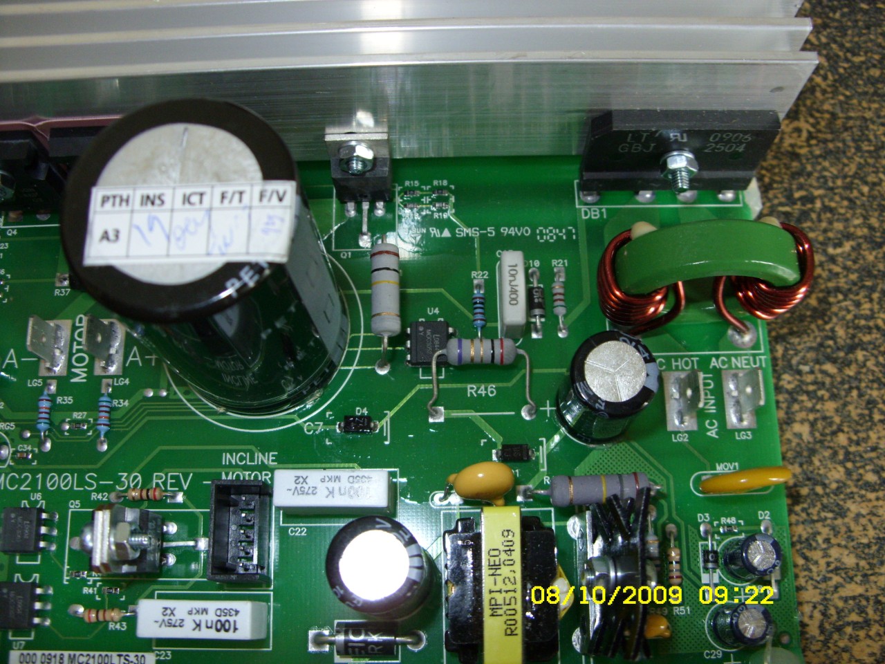

Due to a power surge a resistor on the Motor Control board of my treadmill cooked. It is likely that other components are also toast. However, since resistors are cheap and new control boards are not I thought I would try to replace the blown resistor first.
However, it has been a long time since my EE classes in undergrad and this resistor's color code doesn't make any sense to me. It seems to be an impossible combination since it either begins or ends with black ... which I thought you couldn't do ... also there are 2 gold bands in the middle ... which doesn't seem correct. To me it looks like Red, Black, Gold, Gold, Black (or the reverse).
Any help would be appreciated.

Since the red is farther (seems atleast) from the black than the orange is from the leftmost black. Unless there's silver/gray next to the red, hard to see... (edit: just glare from the flash more likely)
So it would be 033*10^0±2%. And by size, 1W?

Is that an axial capacitor?
10 picofarad, 20% tolerance, 250V?

This site ( http://www.ankaudiokits.com/resistorcodes.html ) has a calculator for 5-band color codes. It comes out as 44 ohm, +/-3%. I'd verify that value with a multimeter, though.
The power rating is going to be a crapshoot, but it looks pretty big so I'd get one that is fairly beefy (1+ W).

I found a replacement board on e-bay that had some good high res pictures of the resistor in question but unexploded.
The pic (R46 in the middle) shows red, black, gold, gold, purple. I guess the heat could have changed my purple band to black (or see Edit below).
However, the digikey site won't take that combination as an input either using their 5 band calculator. It won't let me pick gold for the 3rd band. But if I use the 4 band calculator it comes out as 2 Ohms. Then with the 5th purple band would be a 0.1% tolerance. Does that sound about right to you guys? Thanks for all your help so far!
EDIT:
Just found this info from here:
...Generally, If an additional fifth band is black, the resistor is wirewound resistor. If an additional fifth band is white, the resistor is fusible resistor. ...
So either way it looks like a 2 Ohm and my black last stripe could just indicate that it is wirewound.

OP, the other board you posted appears to have some minor differences from yours, at least as far as component source (the capacitors are different colors, and the tolerance value on the resistor at the front of the frame is different).
It's possible that that board uses a different resistor for R46 as well. The one on your board is Black, Gold, Gold, Black, Orange while the other is clearly Purple, Gold, Gold, Black, Red - I don't think the different dyes in the color bands would separate out before the whole thing just burned up.

Wow that is truly screwed up. You're not supposed to have gold on rings 2 of 5 or 3 of 5. That's just gibberish. And the photo clearly shows that it is indeed gold and not orange or yellow. Shrug.
You should remove R46 from your board, then ohm across R46 on your pcb (ohm across the holes). If that resistance is high, then that means the person who owns that known good board can ohm across his R46 and that reading will be accurate enough to let you know what the resistor actually is.

Why would a 5% resistor have a 5ppm temperature coefficient? And how are you supposed to know that this resistor only has two significant digits (2.0 ohms) when most resistors with 5 color bands have 3 significant digits (2.00 ohms)? I have dozens of different kinds of 5 band resistors right in front of me and they all have 3 bands for 3 significant digits, followed by a multiplier band and then a tolerance.

How would you express a single digit value? There is no "decimal point" color. To express two ohms, they give you 20 in the first two stripes, then a negative multiplier to reduce it to 2.
I guess it's not so much a "negative multiplier" but the "number of zeros to add" ... in this case it would be "subtract one zero."
The 5ppm is in Kelvin and apparently in addition to the precision. For a resistor of that value, it is likely to see some heat, and that may be a significant change. Plain carbon resistor change value as they heat up, the ceramics are more stable, all types have different characteristics.
Resistors in that value range tend to be high-wattage as part of a current limiter or power power divider.

Are you absolutely sure the resistor is burnt out and not something else? Resistors are pretty hardy fellas, even to pretty extreme power surges.
imagoon
Feb 19, 2003
5,199
Considering it shattered the dip and you can see the internal coil, I would consider it burnt out.

^^ That would be my guess too, that the resistor has merely lost some of the coating but is electrically ok, that maybe a switching transistor is fried but an equivalent replacement shouldn't be expensive.
Anyway, check continuity on the resistor legs. It's weird that you didn't mention any tests like whether you measured a resistance across it.
Physically damaged and ought to be replaced yes, but in the short term it may be electrically functional, not necessarily the reason the board doesn't work.

True but for a resistor (or any component really) to blow apart its package, something had to heat up and be converted to gas to breach the package. Generally that changes the devices characteristics. However yes I agree that the board itself may (likely) have other parts that are bad. I mean a resistor is a 2 leg device... something else on the board also had to sink that power. You hope it was a varistor that is also easy to replace and is supposed to be the device that dies to protect the board but you never know.
mindless1
Aug 11, 2001
8,749
1,759
^ Less true for wirewound resistors than many other components. IF the wire is intact the package doesn't matter except for eventual degradation from heat -> oxidation.
