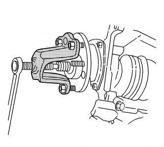

The puller isn't exactly required, but does make it easier to remove.
Front Wheel Bearing and Hub Replacement
Tools Required
J 42129 Wheel Hub Remover
Removal Procedure
Raise and support the vehicle. Refer to Lifting and Jacking the Vehicle .
Remove the tire and wheel. Refer to Tire and Wheel Removal and Installation .
Disconnect the wheel speed sensor electrical connector (2), if equipped.
Remove the wheel speed sensor electrical connector from the bracket, if equipped.
Remove the front wheel drive shaft nut. Refer to Wheel Drive Shaft Replacement .
Remove the brake rotor. Refer to Front Brake Rotor Replacement .
Use 3 wheel nuts in order to attach the J 42129 to the wheel bearing/hub.
Use the J 42129 in order to push the wheel drive shaft out of the wheel bearing/hub.
Remove and DISCARD the wheel bearing/hub bolts. Remove the J 42129 from the hub.
Important: Ensure that the wheel drive shaft outer seal/boot is not damaged.
Remove the wheel bearing/hub and splash shield-noting the position of the shield for re-installation.

Yeah I know it's for a Monte, Impala is the same though.
