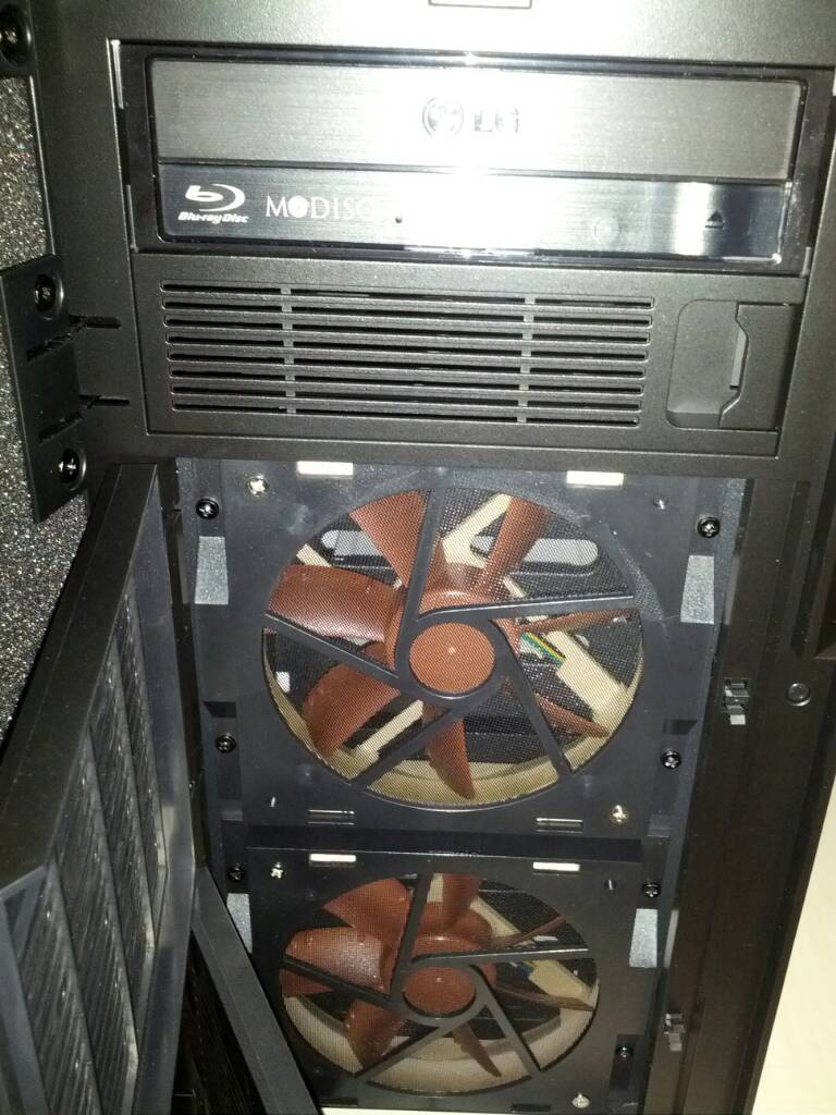

Once you got it all set up, take some pics. I want to see how it looks with those fans on it.
Here we go, looks really nice :) I'm still waiting for the motherboard and choose RAM/CPU.
