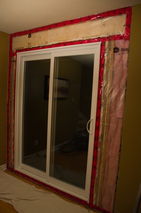

You can save money by removing the old door and redoing the frame, but I'd pay someone to install a new one. Not because it's that hard, but because the door that they will install is going to be much higher quality than what you'll be able to buy at the hardware store if you install yourself.
Did mine a few years back, removed the old and rebuilt the frame so that it can be a standard size (saved a lot of money too as they did not have to do a custom order). I had a bit of rot to deal with too, and some general weird craftsmanship and lack of proper vapour barrier tie in. So fixed all that at the same time.
There is also something nerve racking about having such a big hole to the outside like that. :p I had to put my cat in another room and close the door for this project.
Downside of DIY is that you'll have a hole you have to cover temporarily till the door comes in. For me it took like 6 weeks. I did not want to actually use up new plywood for something temporary so just used some scraps to keep the cat from trying to go outside, and plastic for air sealing.
After the new door was installed I then fixed up the insulation and vapour barrier. Made a huge difference.
