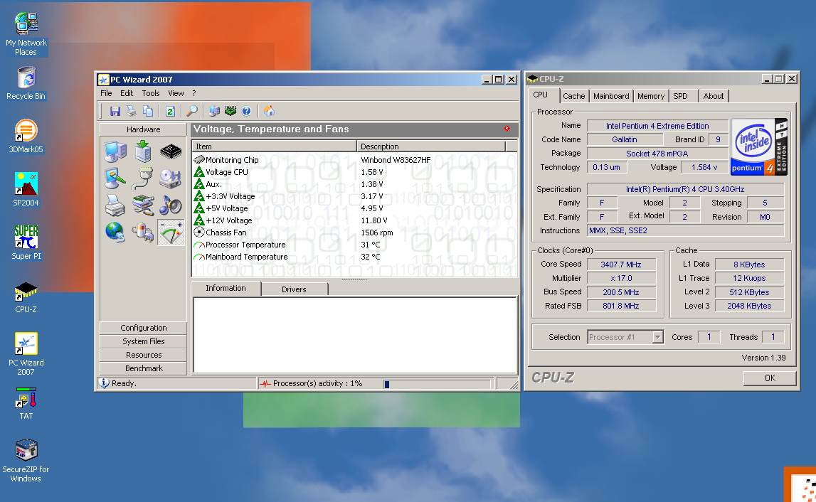

Here you go: My current temps
Intel Extreme Edition -- Tuniq Tower 120 -- MM U2-UFO Opti-1203 -- Antec Tri-Cool fans
There isn't a Lian Li made that will give you those numbers, guaranteed! ;)
