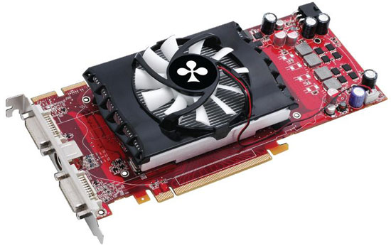

It depends. If her card is like this -
images
Then airflow wont be impeded by placing a new fan onto it at all. Infact a 120mm fan will fix it right up and I would try it. The above is a Club3d 4850 btw but the designs vary..
You are probably thinking of the current standard which use "shrouds", and in that case a new fan wont help much. The bottom card is the stock 4850 which has the shroud design [and it sucked royal ass, I had one before].

I had two 4850 fans with the S2 coolers on them. I modded a 120mm fan on each. They ran cool and overclocked like crazy with them on.
images
