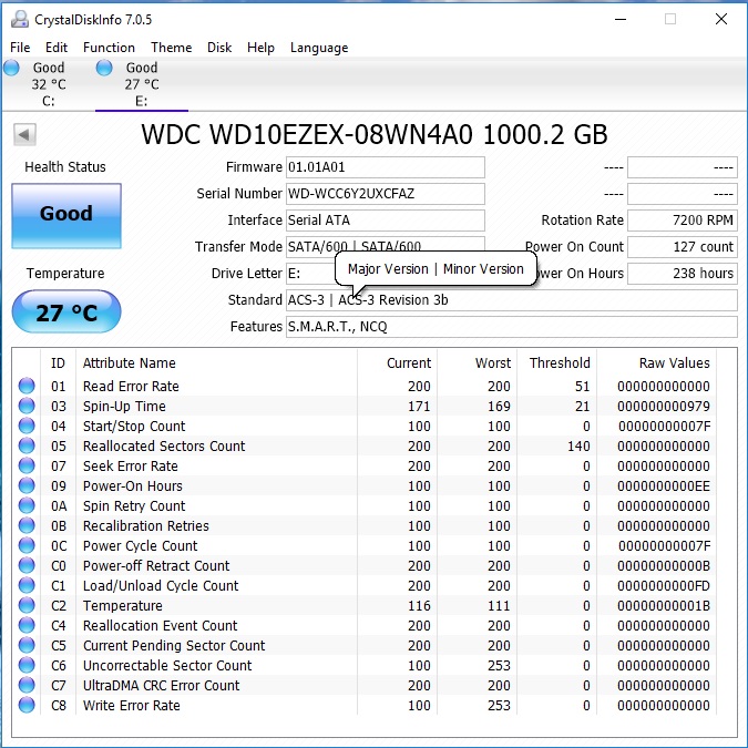

Run CrystalDiskInfo and see what the little lady says about your current HDD

That is correct. Just enable it in the BIOS and CrystalDiskInfo will pull the raw values.
Is that a screenshot of your actual HDD? If so, looks good (Reallocated Sectors Count, Reallocation Event Count, Current Pending Sector Count).
I would have said possible bad SATA cable, but the UltraDMA CRC Error Count is 0.

Also, I've been watching CrystalDiskInfo on every powerup. Haven't seen any issues, but my problem still persists. Here's the latest CrystalDiskInfo FWIW.
