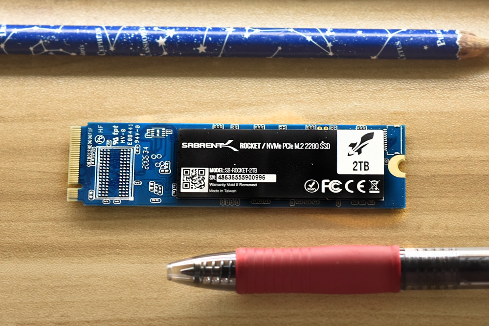

Surprisingly the ssds are more expensive than the pcie3 NVMEs on amazon.
This explains what I was talking about regards to nvme murkiness

just need to avoid the ones you know they pulled bait and switch. I have the good ADATA SX8200 Pro. The Sabrent I linked is a decent one.
https://www.reddit.com/r/DataHoarder/comments/pm0w5k
Thanks for all your advice and input (as always). I'm having trouble finding real world opinions of what NVMEs do for day to day desktop operations and productivity. Everyone talks about their benefits for networking, design software, etc. I don't like installing games on C drives so I won't see any benefit there. Plus most games load once and then don't access the drive much after that. Just wondering if to me they're worth it or not and not finding good useful opinions of regular use. Plus I'll lose two SATA ports.
