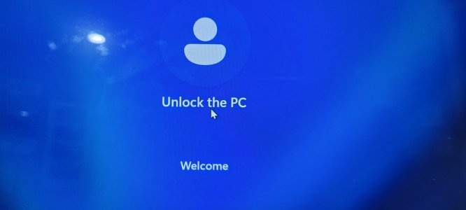

I remote (using Tailscale) into many different PCs, NAS, Servers,etc. When I'm gone I also remote back into my home PC with W11. The other day when I was gone I tried to remote into my home PC but it was doing something I had never seen before. It would show that it connected, but then it would go to an unlock screen. I wasn't sure what was going on because I could not see what my home PC was doing.
I gave up when I was gone, but when I got home I now tried to remote in and the same thing happens. It logs off my home PC, so I know it is accessing the PC remotely, but I can't go any farther. I go into sign in options and turn off the only allow hello sign in, but it keeps toggling back on. I can't remove the PIN or anything. My home PC is the only one that is doing this. What is going on? Thanks.

I finally got if fixed. There were some security things that got changed. I had changed to a passwordless way in Microsoft and that affected my sign in. I had to go and re-enable my passwords and it now works. I don't know how else to make remote desktop work with tailscale or anything if I add a security measure with the passwordless option. Anyone care to answer?
