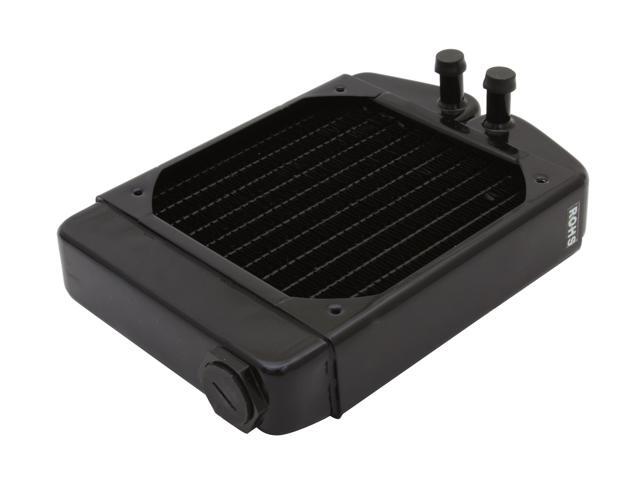

I have a 120mm radiator from an old Swiftech AIO kit, one of the very first I used ever, that I'd like to reuse but it's got a couple of issues. The entire piece is in pretty good shape for being just about 11 years old but it's got fixed 3/8" barb fittings and the paint has started to chip off of the tips, revealing the brass/copper underneath. Also, this radiator has a small reservoir on top with a plastic fill cap that's pretty beat up from regular use over the years. It's just a little hard to look at but otherwise works just fine. I'm not sure what size thread it is but I'm pretty sure it's not G1/4 and I don't think they are sold anymore.
I'd like to tape and mask off the painted bits that are still good, as well as plug the inlet and outlet but I'm not sure what type of paint they use on these things. Is it just a regular black gloss enamel paint that's sprayed on or is it something else? I can post a picture of the radiator when I get home later but it was part of the H20-120 kit that was sold years ago---yes, the one with the tacky neoprene tubing and green anti-kink coils lol

aquarium safe paint if its going to touch wetted parts.
the last thing you want is a residue to start up corrosion.
i would also use a radiator flush you can buy at an auto store and flush the rad out.
lastly if i remember correctly, that bottom fill port cap is a G1/4.
Any barb, or cap should work.
When you get your radiator, or if you have any spare barbs, try to screw it on.
If it fits, then its g1/4 if not, then it maybe a M20

Watched a video by JayzTwoCents on painting a radiator and he used regular Rustoleum universal paint and primer; the only Aquarium safe paint I could find online was just for plastic.
I think I'll just sand the inlets, mask it up, and then flush it again afterward just to make sure there's no loose paint anywhere. Should be fine after I let it dry overnight.

krylon fusion.
You can apply it to metal, it just will flake over time what your currently seeing on your rads.
Personally i wouldnt even bother with it.
I would just sand it so paint flakes dont end up getting into the system.
Once u have the tubing over those barbs, u wont even notice the flaking paint.

Yea probably not, I just figured that fitting the tubing might cause what little remaining paint to come off. Radiator is sanded and all ready for a fresh coat; found some Prestone radiator flush in the garage that I'll run through it after everything is all said and done. Should be totally good to go after that.
