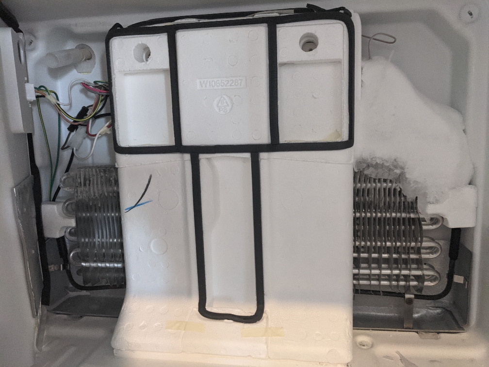

Well I spoke too soon. Even though the fridge stayed fine until early this afternoon from last evening, at 6pm today the water was freezing up. So I took apart the panel on the back and top of the fridge and I could see the ventilation hole (basically just a hole through styrofoam) coming from the freezer. To access it I started taking apart the panel on the back of the freezer so I could take that off and see wtf was going on. Of course I just stripped a single nut out of the 6 total, so I have to go get a bolt extractor bit tomorrow to finish that job up. In the meantime though I looked at every part available for this fridge, and there is no damper related part that has any moving parts in it. Here are all the parts for this fridge:

I opened up the back of the freezer so I could see what was going on with getting the cool air into the fridge. Nothing looked out of wack there. But there was some frozen ice on some of the coils and some wiring on the right half of the back of the freezer wall. I chipped all that away.
The fridge has now been on for over 24 hours and nothing is freezing. That's the longest stretch yet. Who knows maybe that was it.

48 hours later and the fridge is humming along perfectly. Before after every repair attempt, my brita water would be frozen around 18-22 hours later. Fingers crossed.
