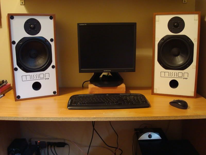

Thanks so much for the help! I am so happy now : )
I kinda just tried all the options until it worked. I got lucky and didn't blow anything out.
Next step is to get a sound card because I'm using on-board sound now. My card blew out a month or two ago and I haven't bought a new one yet...
And these Mission 717s sound so much better than my $20 creative speakers!
