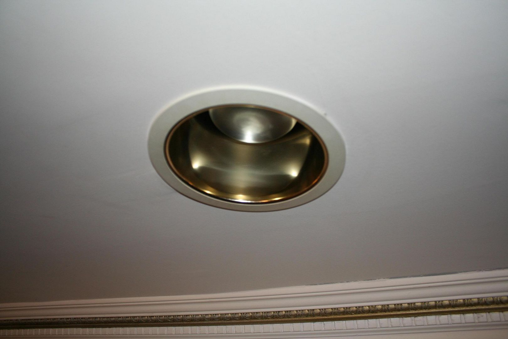

As long as you buy remodel cans and find a good template for cutting the circles and you know how to wire fixtures properly, it should be snap.
Remodel cans are held up by the sheetrock with little metal tabs, new construction cans have to be nailed to the joists.

I should have rattled on a bit more. The remodel cans cannot be in contact with insulation. If you have access to the attic area above where you are doing cans, the new construction will be better in the long run. The IC cans can be in direct contact with insulation.
If insulation is in contact with TC cans, they can/will overheat. They do have a safety breaker that switches them off if they get too hot, and they generally only get to hot if you are using a closed trim on them.
Better to buy IC cans if you can.

These are fairly easy to put in. I added 3 of these recently...well the 4" version. You can pick up a hole saw for drill for about $15 which givs you a nice clean hole too...
Try google for remodel recessed lighting
