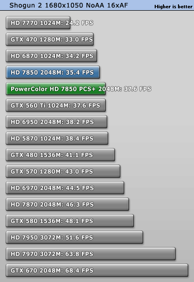

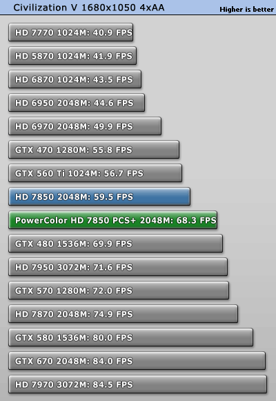

I still have my Radeon 4890 and it's definitely long in the tooth; i've noticed in the last year that on my old C2D rig that the card runs the fan at high speed at all times and the card was running very hot. I would like to keep the replacement purchase under $250 and for it to give me a few years of service until another upgrade. I play the Total War series, Civ 5, Combat Mission, and a few FPS's (though i don't need a card purchased for the sole benefit of a FPS). I noticed that the 'Egg has this GTX 480:
http://www.newegg.com/Product/Produc...82E16814130759
for $209 but i have had a hard time finding any detailed comparison between the 4890 and the 480 due to the age of the 4890. Would a GTX 480 serve me for a few years at the resolution above with high quality graphics settings? Does anyone have a recommendation/practical experience for this upgrade path with the hardware above?

For $250 you can get the HD7850 and have the same or better performance (when OCed) than GTX480 with lower power consumption and without the need for a new PSU.
http://www.techpowerup.com/reviews/Powercolor/HD_7850_PCS_Plus/1.html

thanks all for your thoughts; i can return the psu if it's that much of a problem. with that not an issue, it looks like the 480 and the 7850 are the competitors, and from the graph of the games i play above the performance difference seems negligible.

+1 to 7850, it's the fastest card your PSU will take without the use of adapters, at least until GTX 660 comes along. And excellent bang for buck as well. Should be about twice as fast as 4890.
I can't recommend GTX480 for $210. You can get a much quieter card in the HIS HD7850 for $230 with free Dirt Showdown that you can sell if you don't want it. HD7850 with a slight overclock should match an overclocked GTX480 minus the power consumption or noise levels. Also, HD7850 has 2GB of VRAM which is probably not that important for your resolution right now but given how long you have had your 4890, it might come into play later.
If you are going to spend $250, might as well step up a bit to the HD7950 for $320. The performance increase is very large.
You'll be playing ballpark with HD7970/GTX670 level of performance once that 7950 is overclocked to 1050mhz+:
In fact for games, HD7950 @ 7970 clocks is just 5% within a stock 7970.
