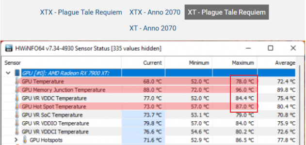

Interesting what is AIB with those high memory temps
P.S I don't think it's with Honeywell PTM7950
Is that on N48 cards?
Perhaps because the memory chips aren't in contact with the heatsinks?
Afaik PTM is for gpu only. Vram chips TIM is used to be a regular thermal pads ca. 1 mm thick. Wondering what's the highest DPM VID for VDD_MEM ?
Are these temps normal for 20gbs chips?

Dunno.

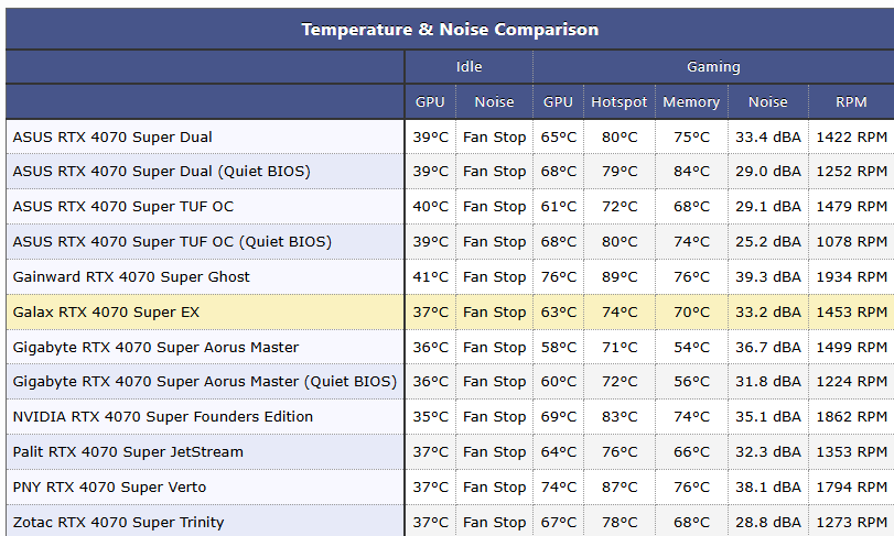

I'm looking at 21GB GDDR6X and here is better temps
TPU has not provided data on VRAM hotspot t° on radeons, so I had to do a bit of searching and found it in a PCGH review. The temperatures are very similar to those on the rdna 3 cards with the same 20gbs chips

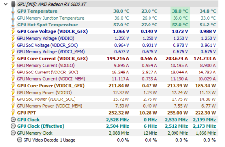

UPD: This is why I'll never go back to air-cooled gpus (7 years with EK full cover wb on vega-rdna1-rdna2 )

yeah, but too big difference now between GPU/Hotspot and Memory
I think its the acer 9070xt. Its 3100mhz 340W with 2slot cooler
Or its asus prime cause napoleon had that
Or its gigabyte cause i think they used thermal putty instead of pads for mem cooling
I know when i browsed all cards to gather size data i saw one use putty for vram instead of pads.
Thermal putty should perform better than pads.
