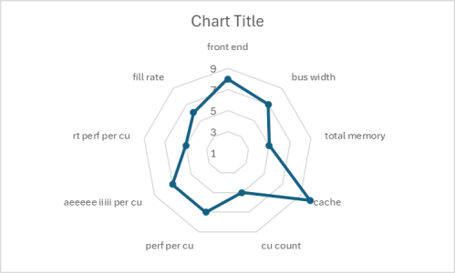

you can take that logic and shove it in the 8gb vram doesn't matter thread, these products should be built to perform as best as possible, period.
what? this makes no sense no matter what direction i approach it in
edit: you got 60 points to spend ( in effect cost) what is best?
