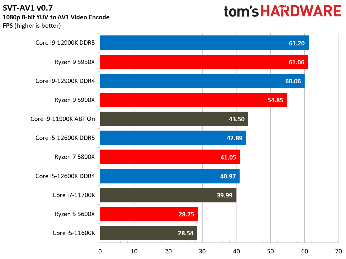

One workload where Alder Lake really surprised me in its performance was in encoding; specifically AV1, the next standard. From what I can gather, encoding is pure integer am I correct?
Here the 12600K is nearly 50% faster than the 5600x, and the 12900K manages to edge out 5950x. This to me solidified how potent the Golden Cove core is, because this is a hard workload for any CPU.
This graph was using Windows 10, as it had much higher FPS than the Windows 11 one for both AMD and Intel.

AMD may be trying to laugh off those E's right now but they are going to be a thorn in their side I predict. 8+16 Raptor Lake assuming no IPC improvements is going to score around 35000 in CB R23. That would require a 33.5% boost in performance for Zen 3 for the 6950 (or whatever) just to match it. With the tiny amount of die area a Gracemont cluster requires for the MT compute it provides it's going to be relatively easy for Intel to add clusters should they need MT performance.
In addition, Intel can increase Golden Cove IPC by adding more transistors, which can be recovered by the E's in a sense. The hybrid approach gives them flexibility to compete moving forward.

Not sure here... While its nice to get more MT performance, it all depends on the task. Case in point (and I am sure there are other real world examples) when I do DC work, it creates 32 threads (32 individual tasks working on 32 different problems) for a 5950x. if 16 of those were gracemont, it would not do as well. Also, there is scheduling, which I am sure will not get totally worked out for years.
I think that there will be a lot of changes in both camps, and alder lake is certainly a nice step forward, I am just not convinced its the future. CB23 is one application, you need to compare a lot more applications to evaluate.
