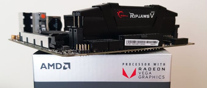

I will bring some APU loving in here. 5700G sleeper HTPC I threw together tonight.
This case is so old the front panel USB are 1.1 So I removed the cables. Slim DVD player still works. :D
ASRock B450 Fata1ty Gaming ITX/ac
5700G +200MHz boost
Noctua NH-L9a
2x8GB Trident Z 4133MT/s
Apevia Flex 300W
15yr old HTPC case w/slim DVD
Next up: results and commentary.

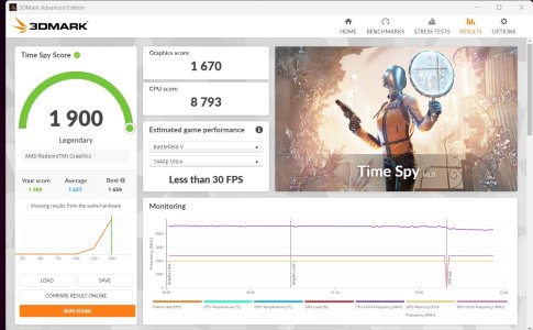

3DMark scores -
Something nerfed with the database. No way those are the highest scores for the 5700G.
Reactions: Zepp
