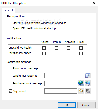

Right, I forgot about how slow updates can be. The motherboards supports NVMe RAID so i guess i'll get that for the boot drive. What I really want is an audible alert when the disks go bad. That's very important.

Whatever you do you want to monitor it too. For my software raids I just have it setup so I get an alert on my alarm view, but I also get an email.

Audiotory alarms in server rooms tend to be problematic. Hard to figure out where it's coming from with all the noise. I find fans even create harmonics at times that sound like a beep so it would be easy to ignore or not notice a real one.

this is a small office
Then you actually don't want an audio alert. Because it will sound until the Computer Guy gets there to turn it off and everybody else will have been listening to it beep for hours at that point, and be ready to effing kill you.

Or it will be more like this:
"I kept hearing something beep in that room and it did not sound good so I just turned off the power bar, I hope that's ok".

Exactly.
The key to IT is to assume that nobody but you wants to realize there's a server there at all.

I actually has this exact problem 2 weeks ago. In most cases i can log into IPMI remotely and silence the beep but i know what you're talking about. I usually do both email alerts and a beep.
