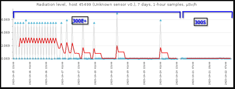

@Skillz, I looked at the stderr.txt of several results of host 45456. Every time, the application claims that it read a CPM of 13358 the first time, of 14136 the second time, and of 0 each time during the rest of the run time. This can't be right. (FWIW, these first four returned bytes correspond to ASCII 4 . 7 8.)
There should be random values all the time, always >0 unless your home is built of lead. The values should be <20 at most places, from what I see from some random sensors on the map.
Here is another host which uses the special GMC-300 app: host 41946. Right now, most of its results got 0 credit because the app couldn't open the COM port. But if you click further back in time in the results tables, there are a few results with nonzero credit, and they are showing random CPMs which are >0 and <20, as to be expected. Before the first <GETCPM>> is performed, the app says "<GETVER>> returned GMC-300Re 4.60" on this host.
On yours, the app says "<GETVER>> returned GMC-300E+V4Re" before the first <GETCPM>>. Maybe you have a device revision which returns a longer version string than specified in the protocol description. I.e., your entire revision string might actually be "GMC-300E+V4Re4.78", and the serial I/O gets confused by receiving a <GETCPM>> before all of the <GETVER>> output was flushed.

Yes, I think the device is reading the data incorrectly. I put it on my main desktop to see if I could get it working (or at least communicating) with the project. I talked with Ian and he mentioned his was doing the same thing until he power cycled his unit. My Optiplex was delivered today and that's what I intend to run the unit on so I will see about making sure the data is correct when I transfer it over to the new host when I get time after work sometime this week.
Two of those invalids (zero credit) tasks I had set the task time to run for 8 hours and they failed. No idea why, but when I set the run time back to 30 minutes the results were validated. The first result was invalid and that's what the instructions I read suggested might happen.
Also one thing I did notice and that's this unit uses a USB-C port which indicates it's a redesign from the older Mirco USB versions I've seen pictures of. Not sure if that means anything.
The LCD on the device reads 0 all the time. It doesn't change. Ian said his did the same, until he power cycled it. Something I didn't do. I just plugged it into the computer after installing the drivers and began using it. Thinking the data was good since the results were marked valid.
The bogus results which I saw yesterday already received credit.

So the first data from the device had the same bogus 52 46 55 57 values which I suspect still belong to the firmware version string. But then the device sent non-zero CPMs. The first one (98 00 = 0x6200) seems bogus. The next several ones look good. But alas, the byte order is evidently the other way around than the app expects:
E.g., 7 0 most likely should be taken as 0x0007 = 7, not as 0x0700 = 1792 as the app did. At such a level I'd worry about Keith's health. I suspect this trouble with byte order was because an uneven number of bytes should have been discarded before proceeding with <GETCPM>>.
After a while, the app gets unable to read/write the COM port.

As @gsrcrxsi pointed out in previous posts, the data reported using the GMC-300E+ detector is significantly influenced by the first 2 <GETCPM>> commands. Data collected from these first 2 commands are ~13,000 CPM. Normal background CPM is usually greater than 0 and less than 50 CPM depending on your location. If you choose a short task time (0.25 hours), the 24 h average of uSv/h will be abnormally high. As you increase the task times the 24 h average of uSv/h will drop but will still be higher than the actual average displayed by the detector (~0.13 uSv/h). The plot below from the map at radioactive@home shows uSv/h over time from my detectors. You can see as I increase the task times, uSv/h decreases when using the 300E+ detector. When I switched to a 300S detector, I'm seeing a 24 h average of 0.13 uSv/h which is what the detector shows on the screen. Also, the plot after I switched to the 300S is flat (no abnormally high peaks). As @gsrcrxsi mentioned above, the 300S only has abnormally high reading after the first <GETCPM>> command. Subsequent readings are in the normal range. The 300E+ detector shows abnormally high readings in the first 2 <GETCPM>> commands. Perhaps the program removes the first data point before processing the data?
EDIT: I believe the red line is the 24 hour average of uSv/h which is calculated from the raw data (blue data points).
EDIT2: I have the detector connected to my laptop and the OS is Win 11.
The first CPM reading isn't removed, but it is treated differently.
