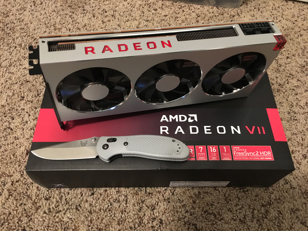

Received an Asrock Radeon VII yesterday from Newegg (storm here in the East coast delayed delivery a day). Paid $699 plus tax so @$750.
The card came in an AMD box with nothing but the card and a small pamphlet.
Very solidly built.
Took a bit for my 2700x/GTX1080 rig to recognize it but finally got it running.
Removed all of the Nvidia software AND updated the Radeon BIOS via the download from Asrock
Then installed the AMD new Adrenaline drivers. I'm still learning where all of the adjustments are.
Fast video card.
Once I have time to play with it I'll report more of my findings.
