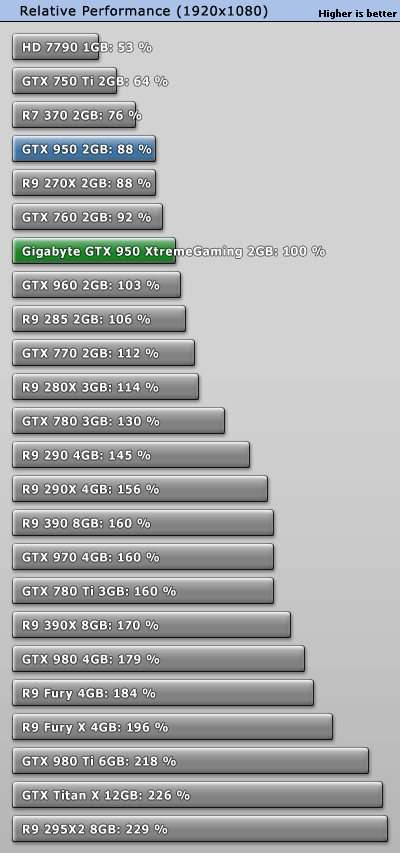

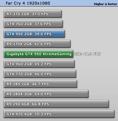

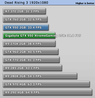

I am going to list the cards in terms of actual performance.
The best card to buy around $300 is a used after-market R9 290 (1st pick) (many of them on Kijiji). The next best card is a used GTX780 (2nd pick). Below $280, only HD7970 / 7970Ghz editions make sense as everything else is overpriced in the used market in Canada. More on that later.
If we are discussing strictly new, the next best card under $300 is an R9 280X (3rd pick).
NCIX
Newegg
The next best card is the R9 380 4GB (4th pick). Can be easily found for <$300.
The next best card (5th on our list) is the GTX960 4GB.
Here is how these cards line up at 1080P depending on the review:
10705
http://www.computerbase.de/2015-08/nvidia-geforce-gtx-950-test/3/#abschnitt_tests_in_1920__1080
