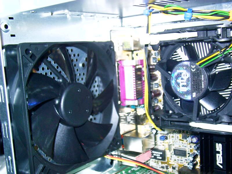

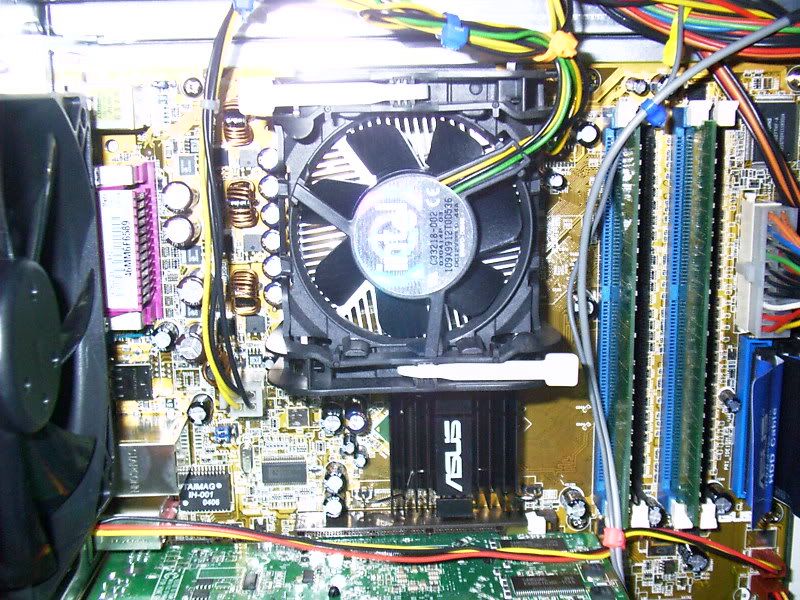

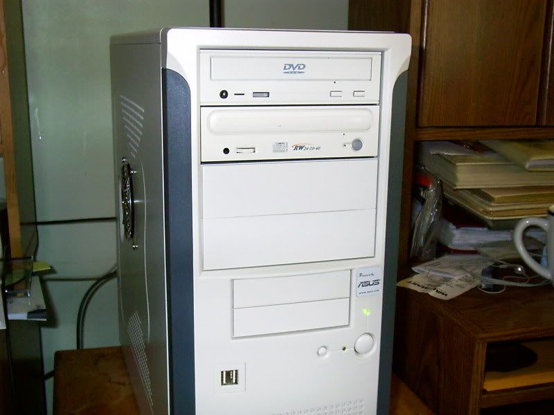

I appreciate your input here :) I've posted a couple of pics of the case itself and of the area around the cpu. Any suggestions on what won't fit? I don't think I have room for the Big Typhoon... (pics have stock HSF, before I put the obnoxiously loud Tt SPARK 7+)
HSF and Rear 120mm
Top view HSF
Case Exterior
(pay no attention to my attempt at neat wiring, this is getting completely redone very soon)

I think you do have room for the Typhoon, although you might have to remove the fan on the side of the case. The Typhoon has a 120mm fan, so to get an idea of space you can center a same size fan over the processor.
An Thermalright XP-120 would fit fine as well, as it does in my case (I also have rear 120mm exhaust fans -- fits with about 5-6mm to spare)
I really think you could fit most anything you want.

Careful...I have a similar motherboard (SE version) and there are some issues with larger heatsinks running into the power supply. The socket placement is very high up on the motherboard.
For instance, you can (barely) fit the Zalman 7000, but not the 7700. I don't think you'll be able to use the Big Typhoon or any other cooler with a horizontally mounted 120mm fan.
Check manufacturer's compatibility charts, they usually have specific info on that motherboard.
You'll be able to use pretty much any heatsink using a horizontally mounted 92mm fan, and most of the vertically mounted 120mm ones.

Wait a minute...crap...lol...
The ninja won't work on that motherboard with a 120mm fan. Neither will any other vertical mount 120mm fan.
The distance is still 60mm from the center of the processor, too far for that mobo. The only way you'd be able to do it is to mount the ninja with the fan on the underside of the heatsink, blowing up (towards the power supply). Best case scenario: blows warm air directly into the power supply. Worst case: air reflects off the power supply housing and creates warm air pockets, choking both the PSU and CPU heatsink.
I mean, unless someone has a Ninja on a p4p800 or variant and can share their experiences with it...I can't find anything on the web.
Sorry man. Look at the 9500 if you can afford it, or the xp90.

To see what you're looking at as far as distance, compatibility etc., you can use Zalman's chart as a guide. This is for the 7000, which is 109mmx109mm. They list the amount of distance you need from the edge of the motherboard retention guide to the power supply as 1.7cm. That means for a 120mm fan/heatsink to be able to fit, you'd need at least 2.8cm from the edge of the retention guide to the power supply.
It's possible that your case mounts the motherboard lower, but it's doubtful looking at the pictures.
