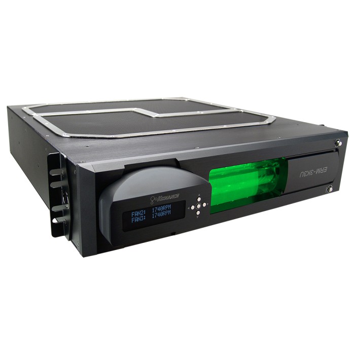

But if i cant get this to work, then i guess im gonna have to just watercool the entire rack with this guy.
Then i would need a taller rack.. :\

Also, (I just managed to take a look at that cool looking radiator + pump), keep in mind that that design is completely in conflict with traditional rack design and especially a silent rack.
A rack is designed to make sure that all airflow is front to back. That radiator flows top to bottom. That means that you'll need at least 1RU underneath your radiator, and at least 1RU above your radiator. So a 2RU radiator becomes 4RU.
On top of that, to keep your rack quieter, and improve airflow, you want to put covers on all unused RU's, to totally seal off airflow between front and back, except for what is passed through the servers.
By sealing off the front, your radiator would be limited to recycling the hot air exhausted by your servers. If you had a well-sealed rack (to keep it quiet), you'd likely find your temperatures higher than air in no time.
