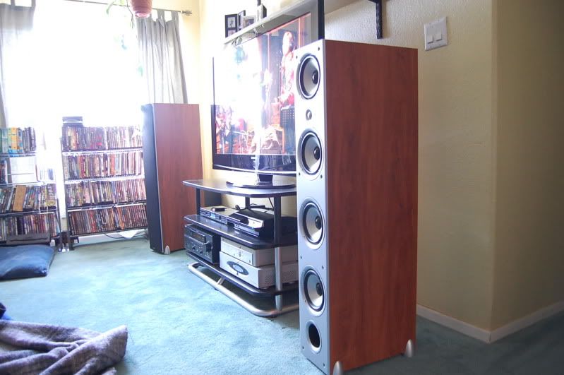

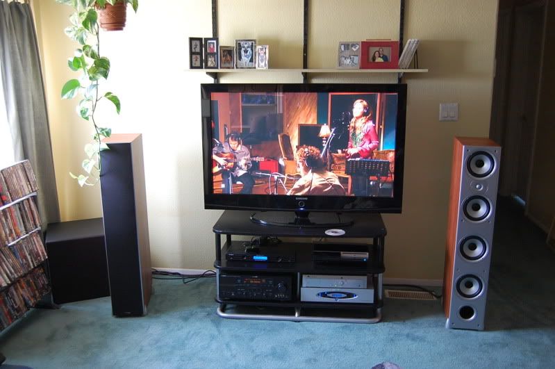

aosfjkasjfskfjkl cant decide on cherry or black! i was gonna go black for sure, but cherry is like $25 cheaper on the center alone! anyone have any home pics? its hard to find any on the net...
damn, thanks. that cherry really does look good in those pics. im thinking it is more well suited to lighter theater areas than darker environments, where it may be too bright. appreciate it!
Bought a black CS2! Woooo. It was $23 more expensive than cherry which is kind of annoying, but cherry would not really work in my man cave. Pretty excited to set this up. Should make it a total pain in the ass for me because im gonna have to figure out how to fit it, and then ill have really mismatched speakers for a while haha. Although that will make me get the other fronts pretty fast. 😀
