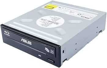

Using a 12V 5A power supply, does this Ugreen new CM257 adapter support this Asus 5.25" SATA DVD drive and can it read and write discs or no? i use Windows 10

You have not given us the model number of the optical drive so we cannot check its specs to be sure about power.
I do see in some online posts that some optical drives do not operate exactly as SATA hard drives, and so whether this can work for you may depend on whether the "translator" chip in the adapter that converts (in both directions) between SATA and USB3 interfaces can deal with whatever the optical drive is doing. One certainly would hope it can work if the drive is designed to work with any common SATA port on a mobo, but that might depend on the driver used by the SATA port.
Thanks for that detail. Unfortunately the ASUS website for that drive does not provide any detail on power requirements. So we have to assume that any "standard" SATA power supply connection from a PSU would be sufficient. The SATA standards do not specify any general power supply values. They do require that the connectors and cable be able to carry three different supply Voltages at up to 4.5 A each, but that does NOT tell us what any particular SATA device may use. Of the three Voltages, very few SATA devices actually use the 3.3 VDC supply, and I doubt that optical drive would need that. I expect the max current from the 5 VDC supply required by that optical drive (doubtless for its electronics) is available easily from the power supplied by the USB3 port you plug that adapter into. And I am sure the 12 VDC power supply module supplied with the adapter (which you MUST use), capable of up to 2.0 A, is sufficient for the motors of the drive. So in summary it certainly appears that the adapter you linked CAN supply all the power the drive needs. Of course, it also provides the data communication needs, too.
