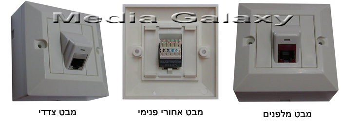

I'm working on wiring my house with CAT5E, and I need to purchase some wall sockets for it (shielded ones, as I'm gonna be using shielded cables).
I've came across this one: rj45-wall-angle.
As you can see on the pic, it has krone inputs for the inner wires of the cable, but I see none for the actual shielding of it (which is what I'm confused about!) it seems this socket has it's own shielding and no input for the CAT5E cable's own shielding, is this considered normal?
Isn't it the same as taking a shielded cable and connecting one end to a shielded plug and another to an unshielded one? or is there something I'm missing here? I thought the shielding is suppose to go end to end in order to be effective, and this doesn't seem to be possible with this one.
I hope someone will be able to clarify this for me.

@JackMDS I am well aware of how an Ethernet connector looks like, that not at all what I was asking about! If you look at the pic of the socket, you'd see it provides a shielded Ethernet port, and this is my point, as there doesn't seem to be a place to attach the shielding of the Ethernet cable itself! that's what I was expecting to see, some kind of screw with a metal piece for me to attach it, just doesn't make sense otherwise (to have a shielded output without the ability to attach the shielding of the cable to it) and I already asked em btw, they were clueless!

From the pic in your post it looks like the connector is On wall type. I.e, it comes with it own box. If the box has a Ground screw it probably grounds the front plate through the two screws of the plate.

Update: after further research (and believe me when I say it took me ages to find it) I finally figured it out. That particular wall socket has 10 punch down inputs (which is 2 more than the essential for the pairs themselves) because the first two (up and down on the right, without the color coding) are used for punching down the shielding of the CAT5E cable itself! can't believe it was something so simple. Guess I'll be going all shielded then (would be a waste to use unshielded sockets/plugs if I don't have to, and again, UTP cables in bulk are impossible to find in my country, only FTP ones are available!) I've actually made shielded patch cables before, as well as passed wires over in-wall ducts, so I'm fairly experienced in that department I'd say. I Just wasn't sure on how to wire the shielding to the particular wall socket. I already got a punch down tool, and I know I should use a solid cable for sockets & stranded for patch cables, so things should hopefully go well!
