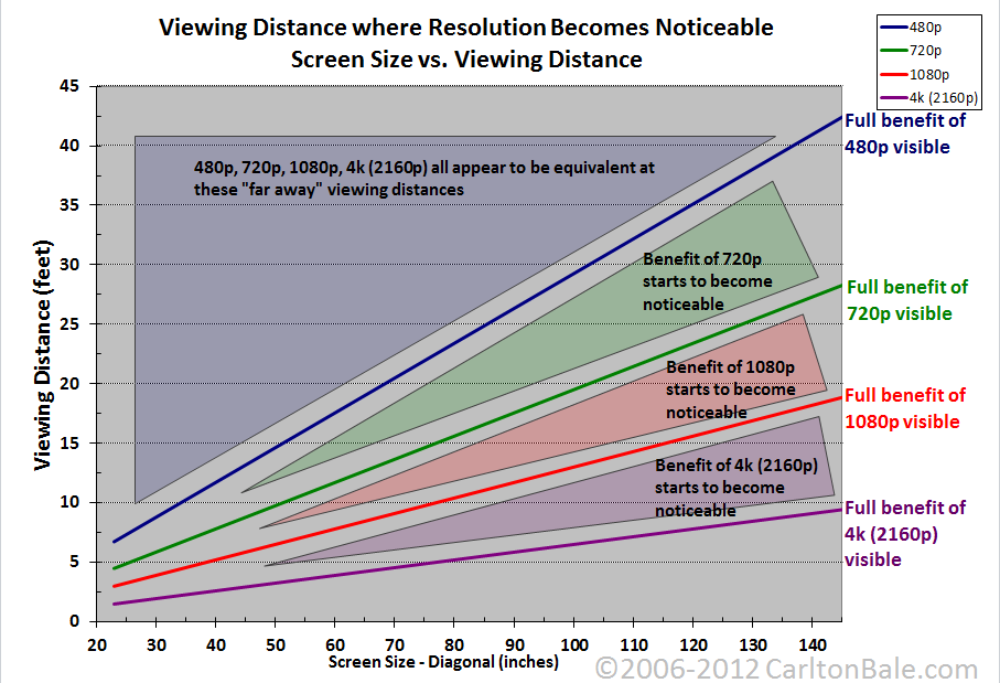

OP, the answer is no. I'll elaborate on it. As seen in the chart above, you won't notice the difference between 720p and 1080p on the 32" TV from 6' or farther away. At that difference the two TVs would look basically the same as far as resolution goes. If one TV has a better contrast ratio (not the marketed contrast ratio, but the real contrast ratio that you'll only see in a professional review), then that TV would look better.
