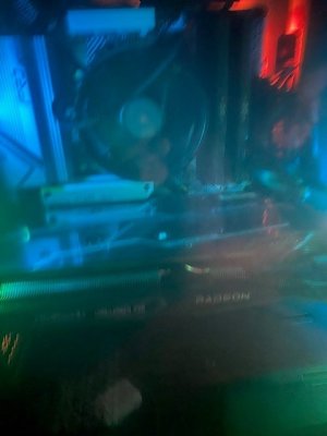

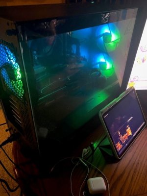

Crappy pics of the rig. So far it's running great, definitely overkill for Roblox, Minecraft runs awesome but gain she doesn't do any modding (yet if ever). It's setup up in our "test bench" aka dining room until she makes some space in her room. Plus easier to access if I get any issues for now.
