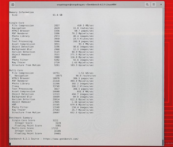

Also the reference device Qualcomm showed for the X Elite apparently had a whopping 64 GB of RAM, gleaning from the Task Manager Geekerean showed in his video.
So this means the entire 64 GB RAM is one module? That would be impressive.
For reference if you look at the motherboard of an M2 Max macbook, the M2 Max chip has 4 'modules' of RAM around it.
It has 4 modules I believe because the bus width is 512 bit…..
