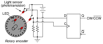

If you are using a quadrature encoder, then what you have is that on the rising edge of one pin, the other pin will be low or high depending on the direction.
The easiest way in software is to indeed use an interrupt for this. The interrupt triggers on the rising edge. And in the interrupt service routine you count the amount of interrupts you had (just +1); and you check the level of the other pin to find out the direction. For example clockwise can be a high level and counter clockwise can be a low level. Then you can use averaging filters (in software) to filter out glitches if needed. This last sentence sounds difficult but it is just using variables as counters and checking these counters on a fixed repetition period for a certain threshold value.
If you insist on not using an interrupt, you are best of to use a little bit of hardware. A so called D-flipflop will store the direction for you. An averaging algorithm polling the clk input pin (which is also connected to the quadrature encoder)of the d flipflop will determine an averaged but rough count. The output of the flipflop will hold directional information in the same way as described as above. Because the output will follow the d input pin when the clk pin is experiencing a rising edge.
This is a most simple explanation where i omitted a lot of secondary information. But it will do. And give you a rough idea. :)
I used the hardware version once for rotary buttons with quadrature encoders in them. But i also used the interrupt version. For motor encoders, you really need interrupts or you are going to have problems determining the angle of the motor shaft...
P.S.
If you only need rpm, you need only one pin but i will let you figure it out yourself. ^_^
EDIT:
One more picture for clarity :
