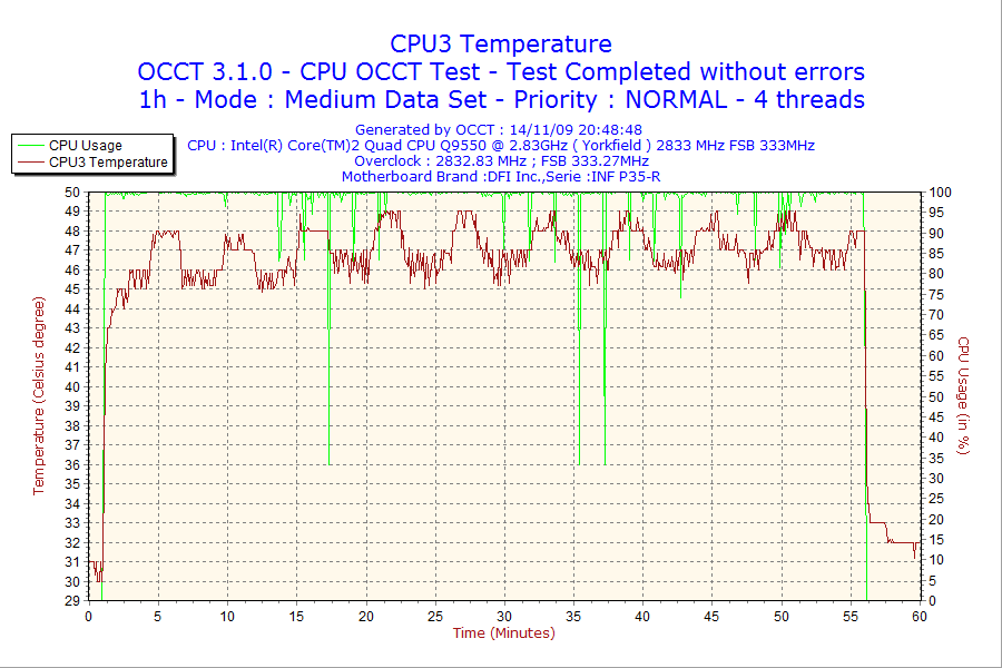

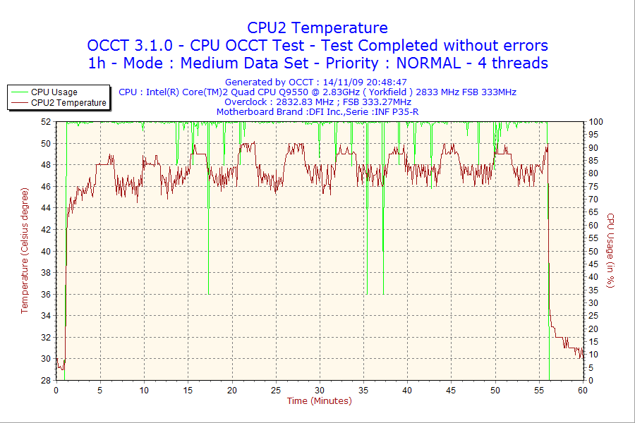

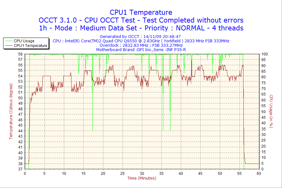

Ok, got everything installed and ran OCCT for an hour. Core 0 is around 55c at load, while the other 3 cores are around 47-50. Note that I am only using Arctic Silver 3. Here are the logs if anyone is interested. I don't have core 4, as I wasn't paying attention and set it to GPU.
http://i241.photobucket.com/albums/ff9/sticks435/2009-11-14-20h48-CPU1.png
http://i241.photobucket.com/albums/ff9/sticks435/2009-11-14-20h48-CPU2.png
http://i241.photobucket.com/albums/ff9/sticks435/2009-11-14-20h48-CPU3.png
So I'm guessing those are kinda high for stock then? I wonder if its due to my HSF, or the thermal compound? Idle temps are 38/30/30/35 with speedstep on.
