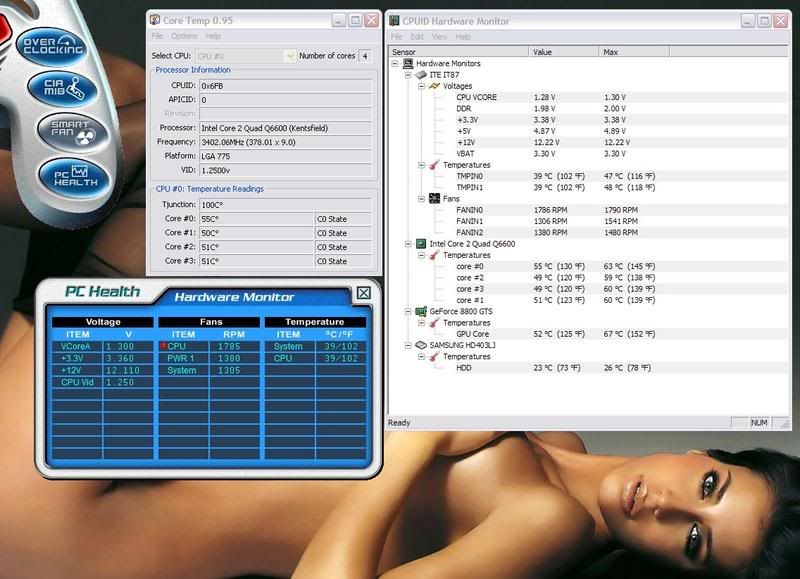

If you "want" to upgrade but don't really play any games or run programs that are slow on your Q6600, might as well wait until Haswell.

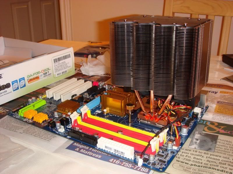

But before you do anything what in the WORLD are you doing with a stock Q6600 on that wonderful DS3L + Tuniq Tower setup of yours?
That exact setup got me 3.4ghz overclock on my G0 Q6600 with ease. That's 42% more frequency for free. Something to play around until IVY Bridge launch. If you intend to play very CPU demanding games such as Starcraft 2 Heart of the Swarm or Diablo 3, then see if an overclocked Q6600 is adequate for your needs (> 35 fps), if not grab IVB. Otherwise, keep running what you have unless you want to upgrade. :p
But ya, overclock on the DS3L is a breeze.

Also, if you are not too lazy, take off the Northbridge heatsink and put some new TIM on it, AS5, or Tuniq TX-2 or something similar if you have some. It dropped my temperatures to just 47-48*C for motherboard temp @ 100% CPU load (I think it was hitting high 50s before that small change).
3.0-3.4ghz is within your reach with your cooler - 55-60*C at 100% load should be doable.

I've got G0 stepping, and when i pruchased my tuniq tower, it was absolutely awesome, i think my fan inside it is crapping out though. Should i replace the fan inside or just pick up this: http://www.newegg.com/Product/Product.aspx?Item=N82E16835103065 and then use that on my new CPU as well, since it works with ivy bridge? If i should just get a fan, which one would u recommend to replace it?
I actually have a small fan attached to my north bridge with a zip tie. How hard is it to remove and then reinstall my NB if i want to put some AS5 on there?
It's not hard. I just used a flat-head screwdriver to push the 2 white pins out from the bottom of the motherboard. Just be careful. Once you push them, the heatsink will still be attached. You just need to twist it and it should pop off. But honestly, if you are already stable at 3.15ghz and you have a fan on top, it's not worth the hassle. It sounds to me like northbridge temperatures are not impeding your CPU overclock. You can always use EasyTune to check your System motherboard temperature. Hardware Monitor is a neat program too.
