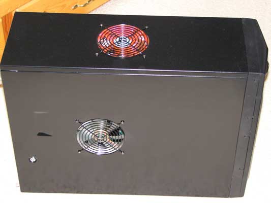

Good thing I have a nice roomy case with decent air flow. I have a Chenbro SR105 extended-atx case.
In addition to the front 92mm and rear 120mm fans, I added a couple more. A 120mm on the side to draw fresh air in over the cpu and and 120mm blowhole on top to help the hot air exit the case.
