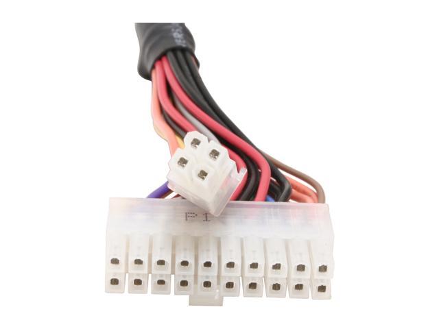

The PSU box has a picture and says "20+4 pin" and it shows the 20 pin with the 4 right beside it, as if it is connected...so I just put these two beside each other and use it to power the mobo?
Also, on that mobo I have linked, my graphics card is too long or something b/c it barely touches the 'fan' thingy behind it --wtf is up with that? Why'd they put that there?
Like this? http://images10.newegg.com/New...mage/17-171-018-06.jpg If so, then yes. It's hard to tell in that picture, but a lot of times these "20+4" connectors actually slide together to make one big 24 pin plug.
