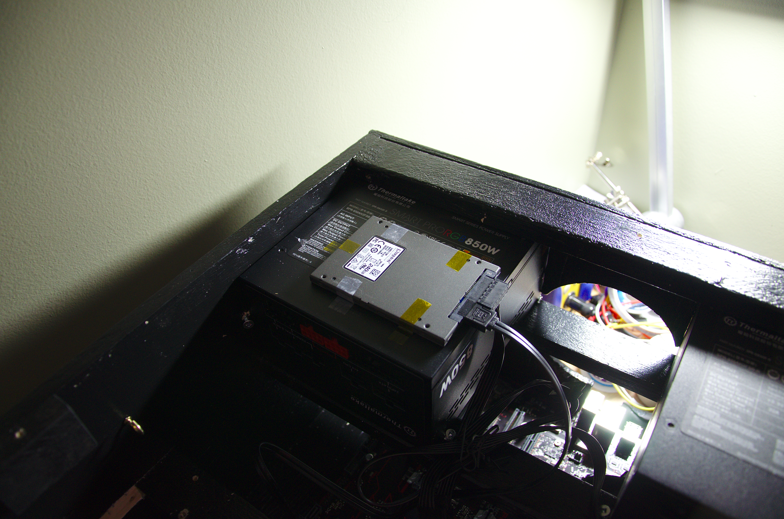

There are quite a few cases that mount the SSDs / HDD on the PSU shroud above the PSU, so as long as your fan is running in the PSU, it likely wouldn't have that much heat built up in it (especially if it's a gold unit or higher). Generally, the higher the efficiency the cooler the PSU runs (better component quality inside).
