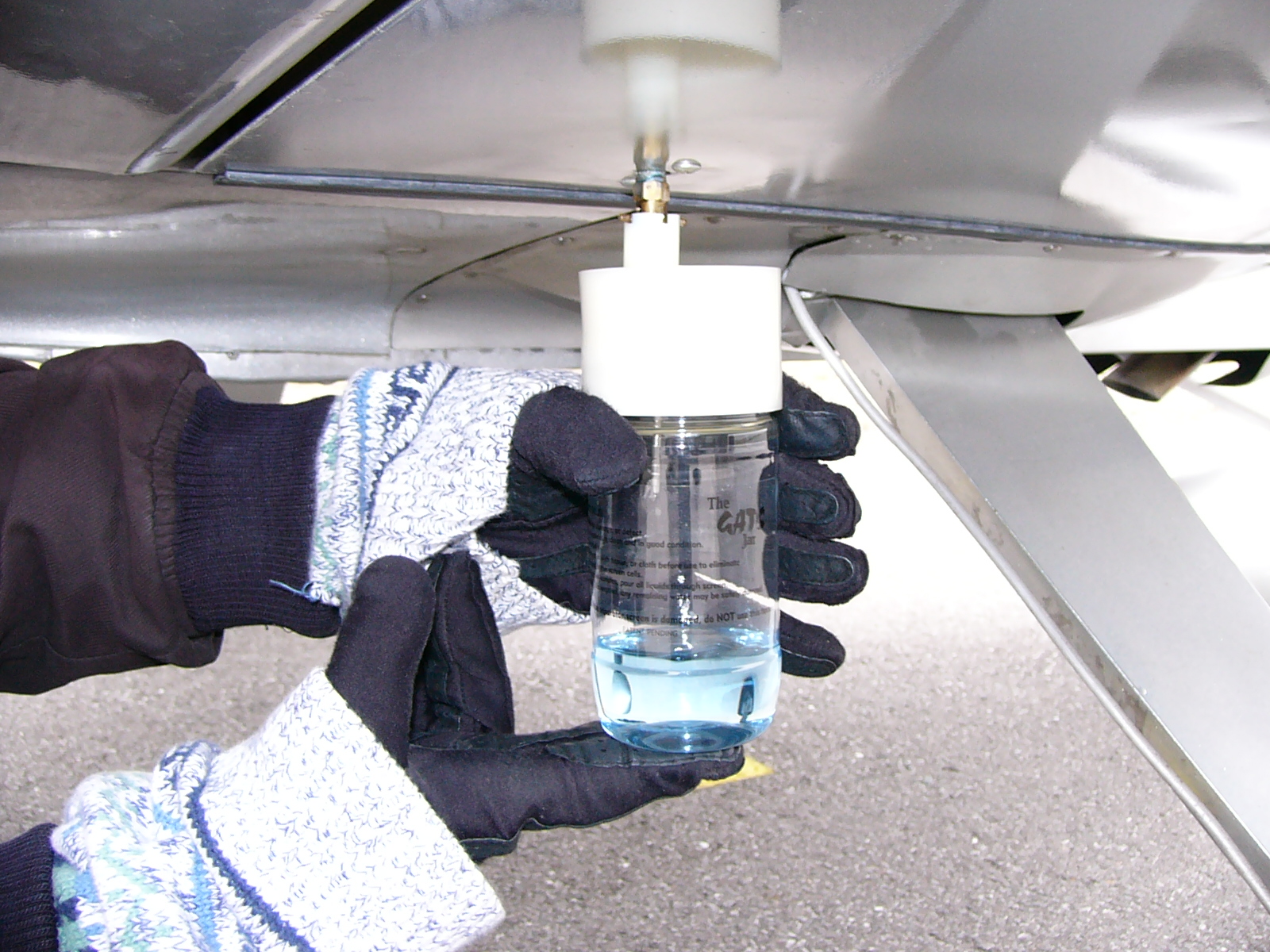

avgas is leaded (100 octane LL) and a nice rasberry koolaid blue.
