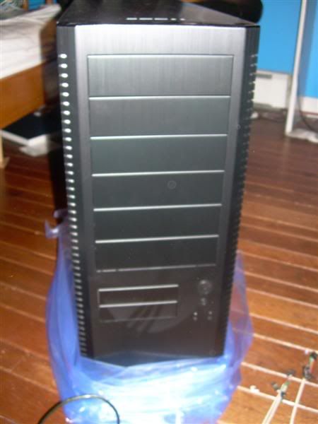

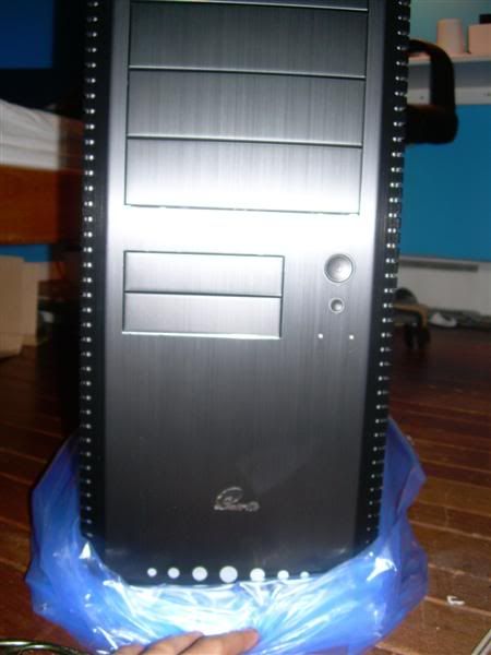

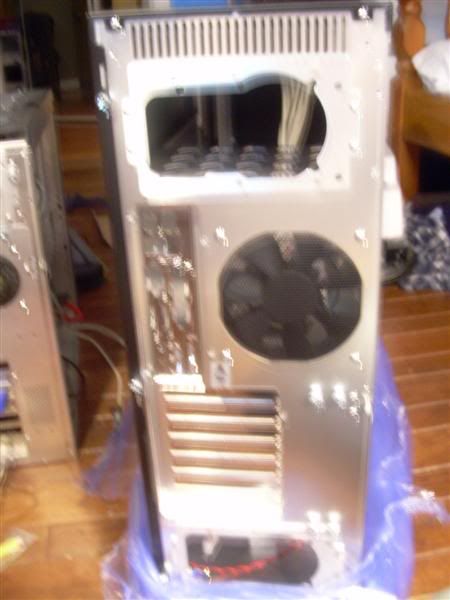

PC-G70B just arrived.
First impressions... MASSIVE.
I thought the packaging may have just been a bit over-done, but after taking it out an setting it next to my PC-60... and several inches longer in both height and length.
My guess would be 2/3 for height, 3-5 for length.
After looking at it for a bit, I realized how gorgeous it was.

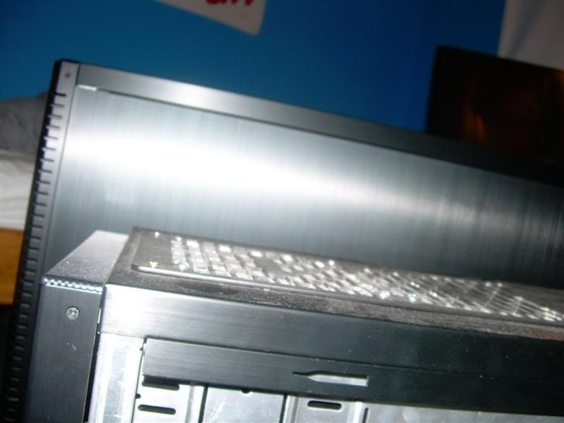

Slighty dinged, maybe a quarter of a square centimeter in total damage throughout the case, exterior wise. Nothing serious that didn't "rub off".

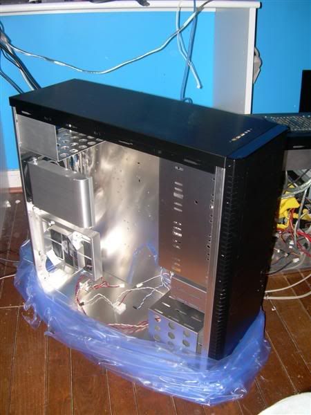

Tons of room inside, lots of space for wire management. Great airflow, from what I can tell. Found the plate to cover the unused PSU spot. Finish on it [plate cover] could have been better, but I don't think anyone will look too closely.

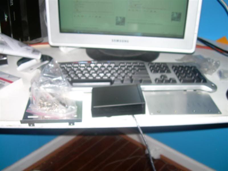

Also included was an odd-shaped piece, floppy-sized, directions make it seem to be used as a 'duct' for the PSU--air is pushed sideways instead of directly out. [According to Galvanized, this is to keep the rear exhaust from sucking in the PSUs hot air, or something to that degree. My back 120 will be external, so it is a non-issue.]
Over 100 screws included. Bag probably weighs in at a pound or so.
Fans are "Lian-Li", so I can't tell who actually manufactures them. No word on noise yet, you'll have to wait 'till I transfer the system over.
Pictures below:

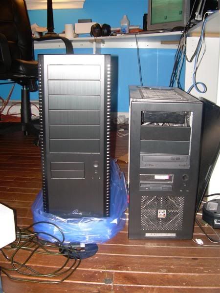

Note the size difference between the two cases. The difference appears even larger in real life.
The radiator will be top-mounted as the current one is, however, it will be a much cleaner job 😉
Once the new PSU arrives I'll assemble the new case. For now, back into the plastic wrapper, back into the styrofoam holders, and back into the box that it came in. Nothing is going to damage this case [except my dremel 😉]
Any thoughts/suggestions/picture demands?
