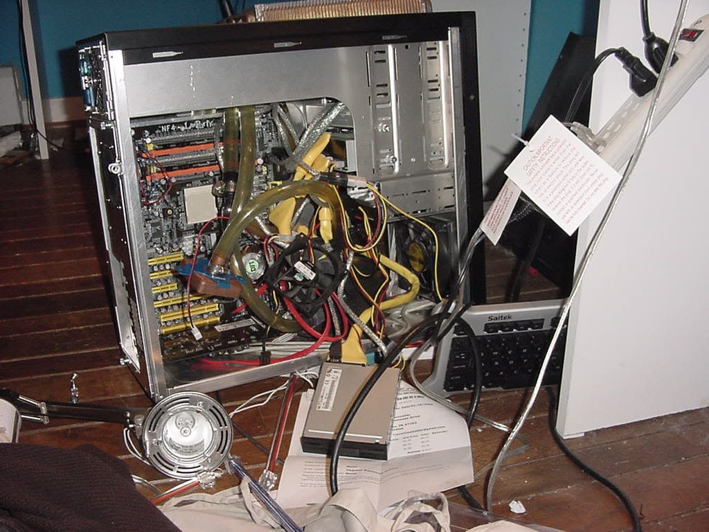

Anyway, here's a quick summary:
A while back, I bought a PC-60B, a 2-199 heatercore, and a few other minor things (i.e.; tubing, an Eheim 1250, an MCW6002)... and recently, I realized that having my box open because I was still 'tinkering' with it wasn't right.
Here are some pictures (it did look slightly better than this, because the case feet were there + the CPU waterblock was attached.. etc..)
BEFORE

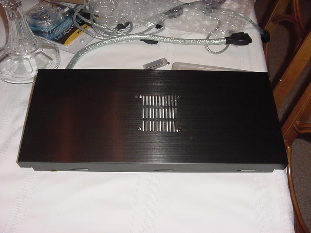

The rather hideous top

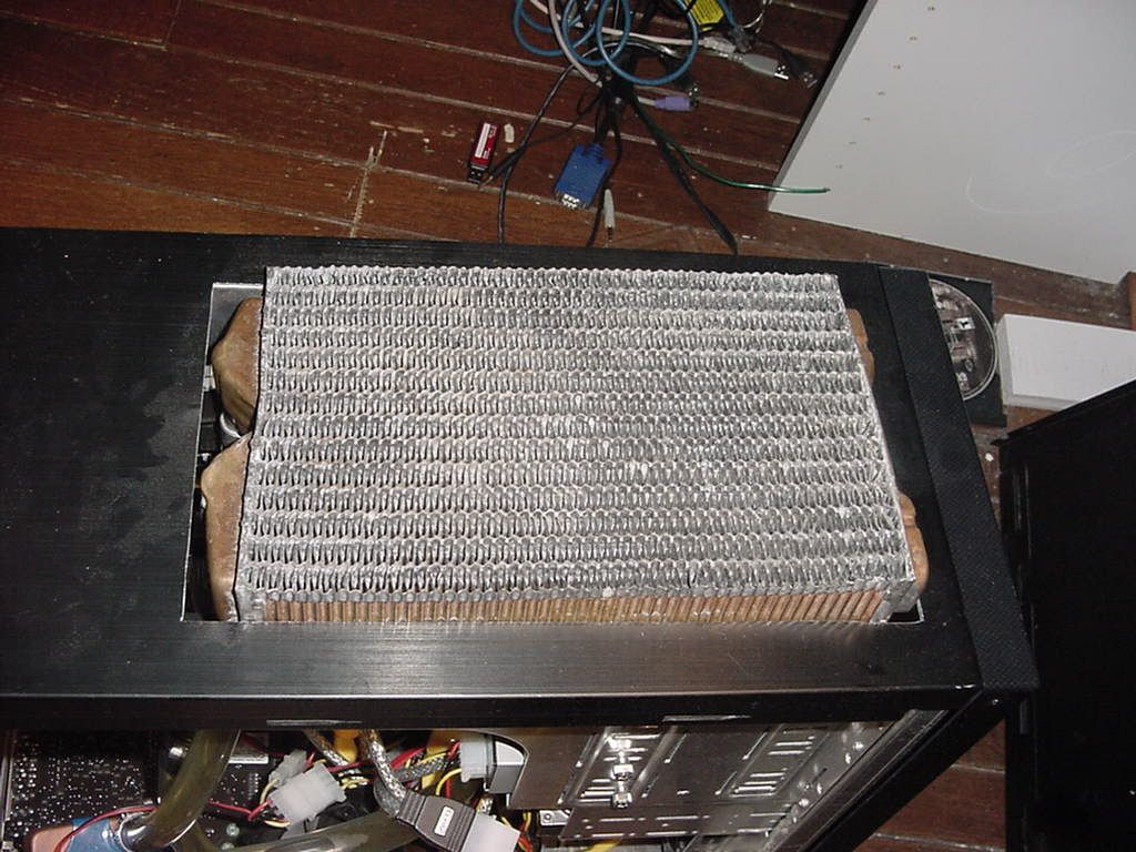

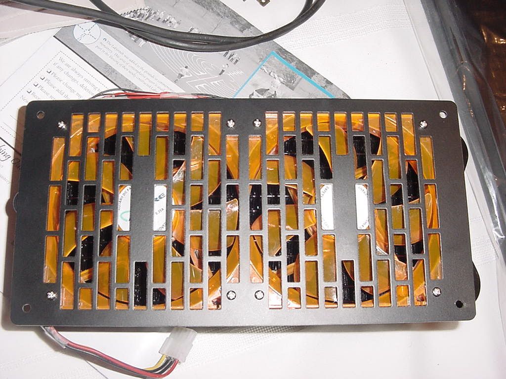

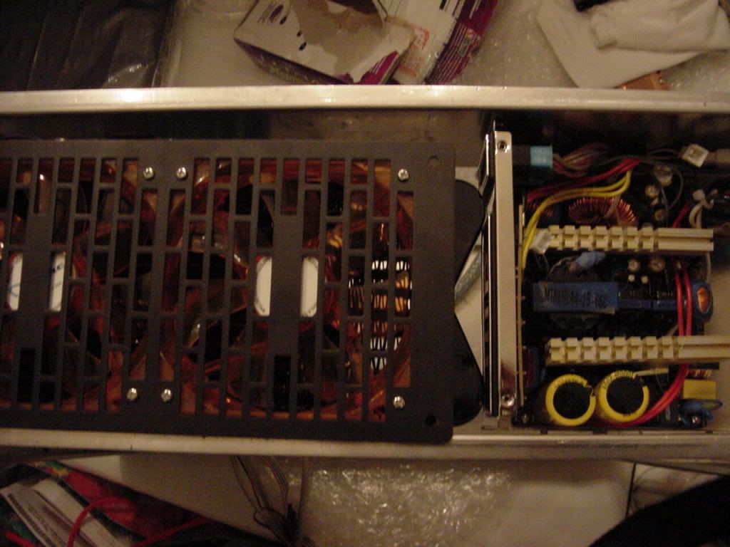

The Radiator/Fans/RadGrill Top-Down
Rad/Fans/Grill, Side View
Bottom of the Rad

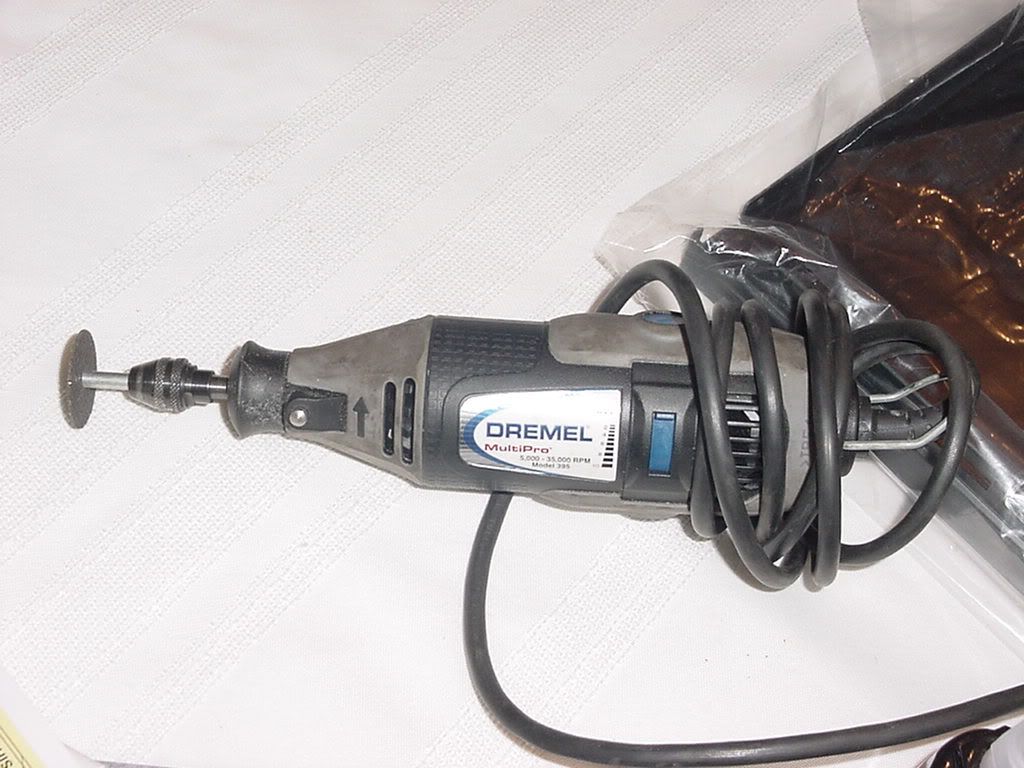

Everyone's favorite tool

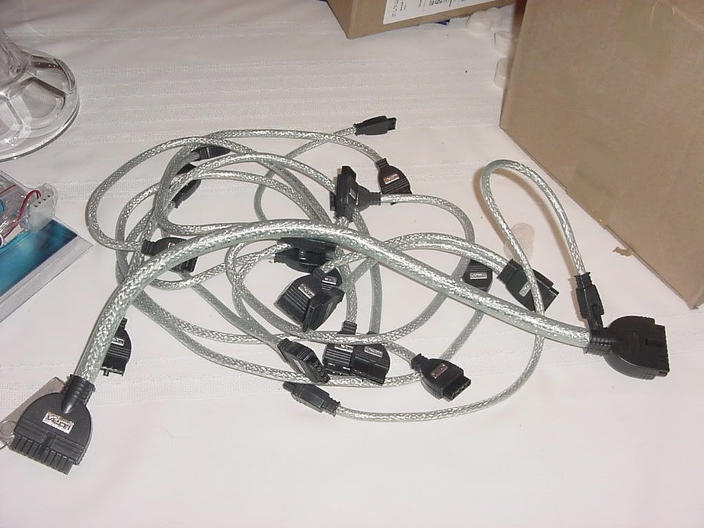

The New Cables

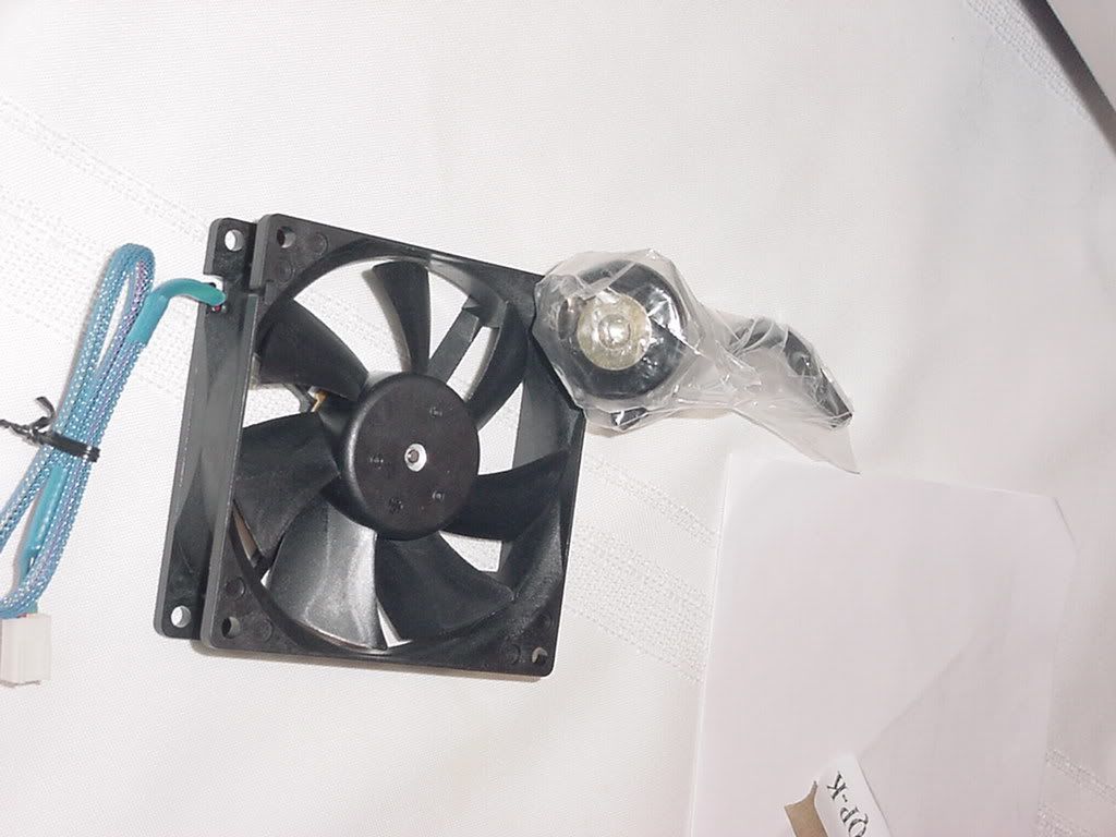

The Fan/Fillport

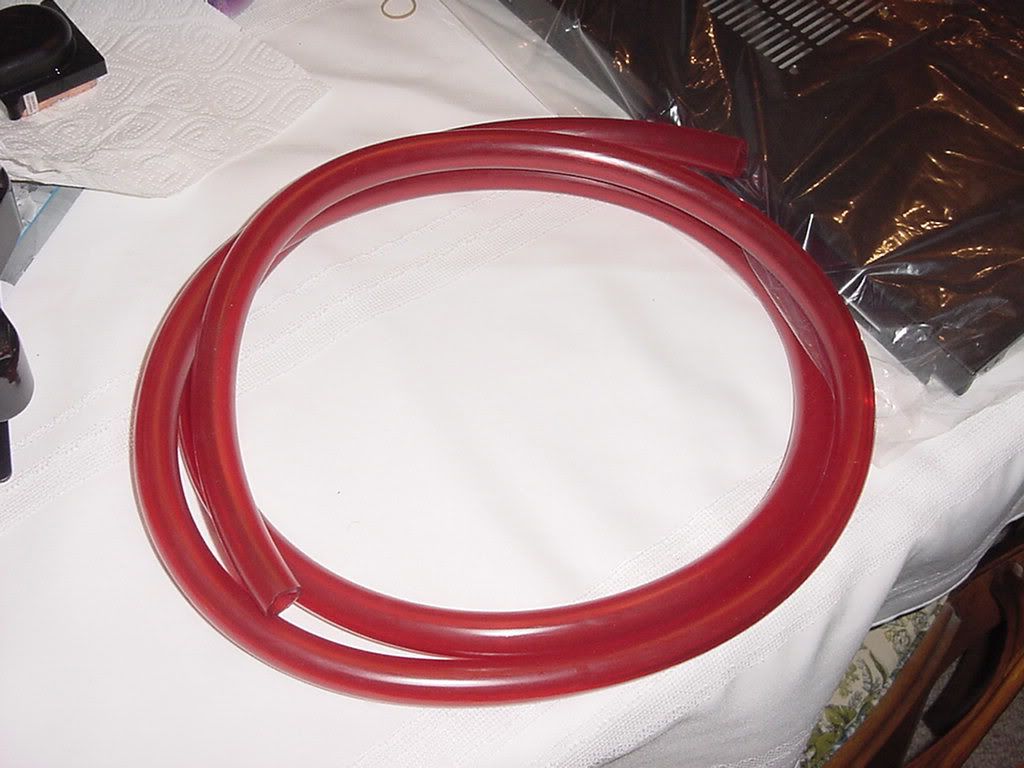

Tubing

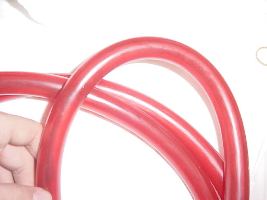

Bendableness before kinking. (w00t for coining new words.)

1) A new Lian-Li PC-60B Case Top. My current one was hacked into in order to support the radiator (which was 2 inches thick, btw.)
2) A secondary set of PSU cables. I plan on modifying these to suit my own needs, for this system only. (Unfortunately, these still haven't arrived. And they were shipped on the 14th. Heh.) Pictures of the case will be posted soon. (Mainly the side, so you can see the wires. I haven't had the case closed in ~3 months.)

5) 7 feet of Primoflex Red Tubing. Nice stuff. Better than Clearflex60.

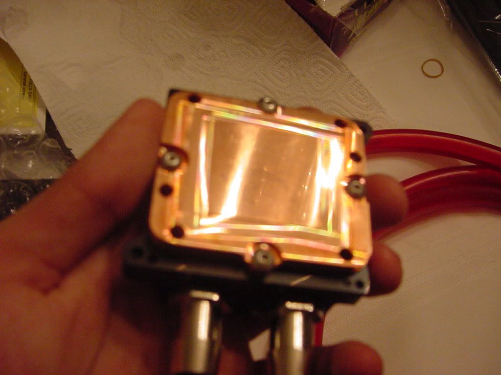

7) A Swiftech MCR220 Radiator (2x120mm Rad. Slightly thicker than the BIP II, but worth the width.)

9) Some fans, to get more airflow through the back of my case and the PSU. 2xPanaflo + Blue LED for PSU exhaust

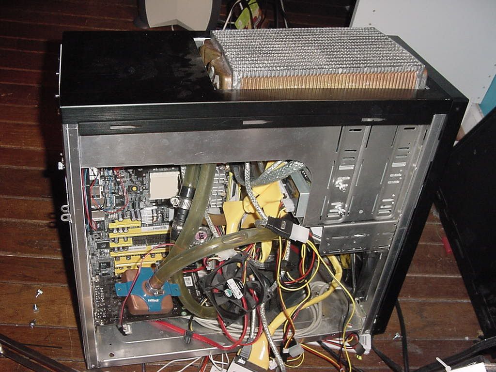

Ran into some problems
1) If I try mounting the Rad in the CENTER of the case.. (at the top) it blocks access to the 20pin ATX cable.
I was thinking of moving it to the side a bit.
(Picture here:
http://img.photobucket.com/albums/v167/trevor_r_C/e2db1f86.jpg and here: http://img.photobucket.com/albums/v167/trevor_r_C/db4c8196.jpg)
Though I'm not sure how great that would look.

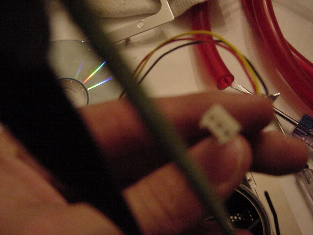

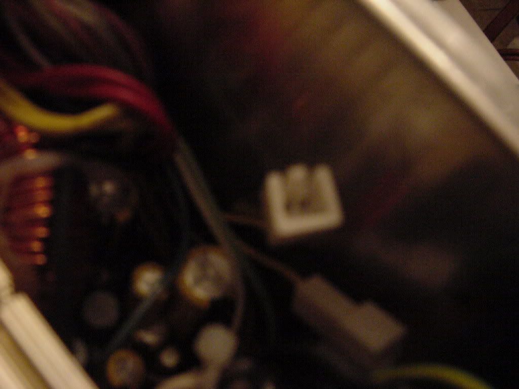

2) The internal PSU fan plugs are 2 pin--mine are 3. Red/Black/Yellow (for mine), PSU only contains Yellow and Black. How do I go about removing the red pin, and binding the Black/Yellow to the PSU fan power outputs?
Thanks!
--Trevor
Also, here are the pics of the pins.
PSU pins:
http://img.photobucket.com/albums/v167/trevor_r_C/927a0147.jpg
Fan pins:
http://img.photobucket.com/albums/v167/trevor_r_C/218237d4.jpg
Thanks.

Here are some more pictures, top-down with full view:
http://img.photobucket.com/albums/v167/trevor_r_C/2c5686bd.jpg
http://img.photobucket.com/albums/v167/trevor_r_C/40b0a320.jpg

Have you considered going for a rear mount on the rad? That's one part of my own project that's completely situated at this point. I'll post some pics of my mounting scheme tomorrow if you want, I've got the same rad (though not the same case).

I've considered it, but I really don't have enough air coming into the case to put it there. In addition, I'm trying to keep everything inside the case.

Should start the dremel work tonight--I've decided that I'll be fine with only one CD/DVD drive, because I usually just rip everything on to my HDDs anyway. (In other words, mounting the thing with the tubing inside the CD drives.)

If you're replacing the PSU fan with a standard one, you probably have the wires wrong. On most fans, red is +12 Volts, black is ground, and the yellow wire is used for RPM Monitoring. If you put 12 volts through the monitoring wire, I can pretty much guarantee that Bad Things will happen.
Painman
Feb 27, 2000
3,728
29
86
Nah, the problem is the plug. He needs the fan to have a plug on it like the one here. It sounds like he's already spliced the wiring from the original PSU fan onto the one he wants to use, so he should be set.
TrevorRC
Jan 8, 2006
989
Yeah, already got it.
Used a car battery charger to test the plugs on the fan, found which 2 I needed to use, and voila. Cut the extra off, took the end off, stripped the two, combine it with the match, wire knut, and you're done.
As it turns out, the two wires coming out of the PSU were black and yellow---and I already knew that yellow was USUALLY RPM monitoring.
So then, match the colors, right? Wrong. Red and Black FTW.

90% done with dremeling. Smoothing work right now.
Unfortunately, I made a TINY slip.
I'll probably use a sharpie to cover it--it'll be completely invisible.

TIP: When possible do the Demeling from the inside of the case. That way, in the event of a slip, the mark will be on the inside of the case. It's almost impossible to score the outside of the case.

Thanks. Thought about this, but it really wasn't possible in this situation (in terms of hand position/etc. I actually tried setting the case upside down on top of two items, with the space in the middle for dremeling--but it kept moving off [vibrations].
The sharpie took care of it. When I get the digital camera back, I'll take a picture of the top of the case and see if you guys can find it :D

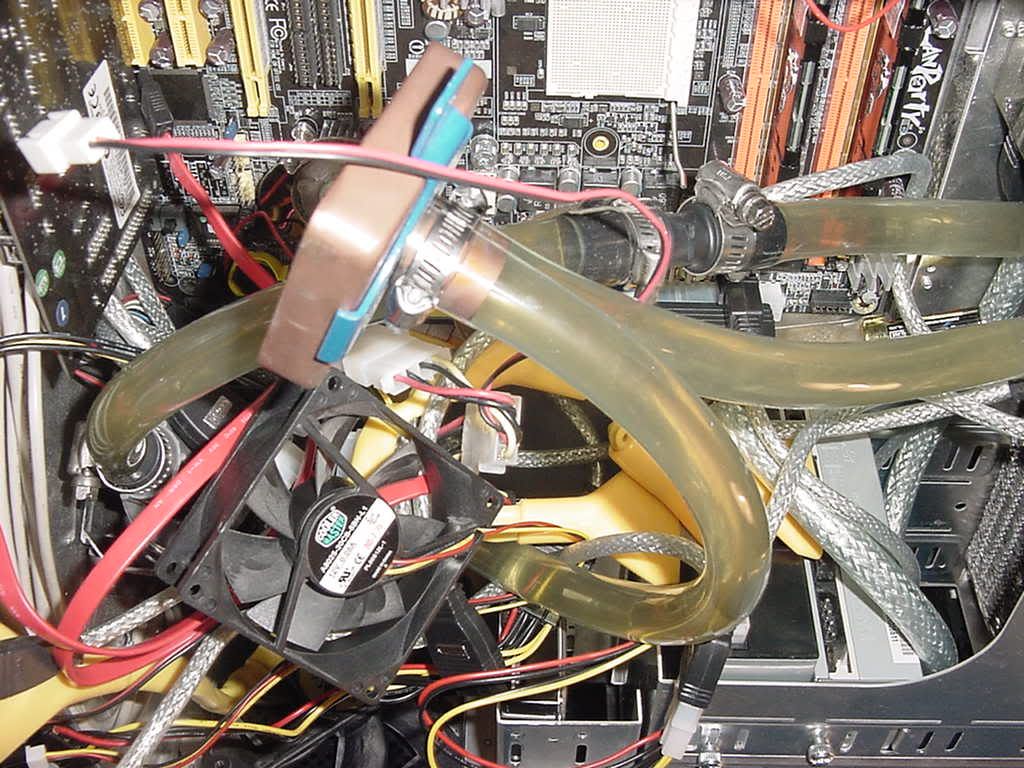

TrevorRC
Jan 8, 2006
989
Project revamp is back online.
Finally got my DD block mounting in.
Took off the casing from the 20pin connector... and it worked like a charm. [For now at least]
Same PSU; though I'm going to be upgrading to a Silverstone ST60F soon enough.
For now, planning out where the water is going; water will be going in Friday/Saturday/Sunday [Unsure of which day. Spring break, and I'm planning 'mod-time' around the parties.]
