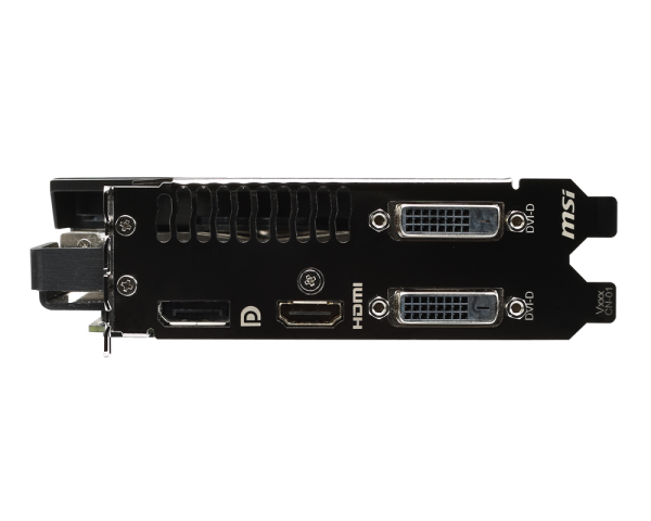

Is this your card?
If it is, then you should note this.
The dvi ports are DVI-D meaning they only carry digital signal.
More on the DVI here.
All in all, your card does not produce any analog signal.
To be frank I find it strange since my Gigabyte 970 still has one DVI-I on board. People may still use analog, like you.
In any case that's why the guys told you to look for an active converter. You are in a situation that you need a device to do the conversion for you.
Unfortunately I am also all digital and I have no adapter in mind that works for sure.

Is this your card?

I'm pretty sure the cable I linked is a display port to VGA active adapter, so it will work, people have been using it with radeons for eyefinity since 2009 (when DP to HDMI active was expensive)
the adapter you posted seems to be an HDMI to VGA cable that is probably not supposed to work, it doesn't seem to have the required hardware inside for this conversion, and your HDMI port can't output VGA signal, so not the same thing at all.
so by looking at the pictures I would expect the cable I linked to work, the one in your post to not work.

DVI-D: Not designed to be easily converted to analog
HDMI: Not designed to be easily converted to analog
DisplayPort: Designed to be easily converted to analog
DP->VGA active adapters are relatively cheap and plentiful. They are designed for exactly this situation.
I've seen people having problem with cheap DP adapters, but the cable on the first link seems to be similar to the one I posted, and I would expect it to work in your case...
Ditto. That's the kind of adapter you want.
