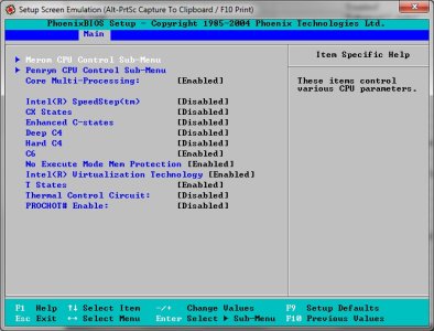

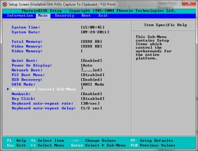

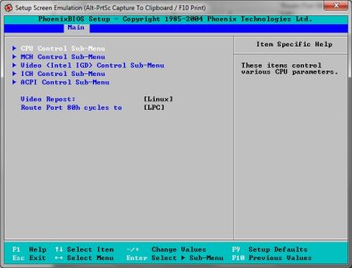

I found several options in the custom BIOS.
I have modified all of these settings to the last option or clearly the highest performance option.

Route Port 80h cycles
Changed from LPC To PCI
I changed this option and also the processor does not support virtualization and made it supported by enabling the option in the modified BIOS
