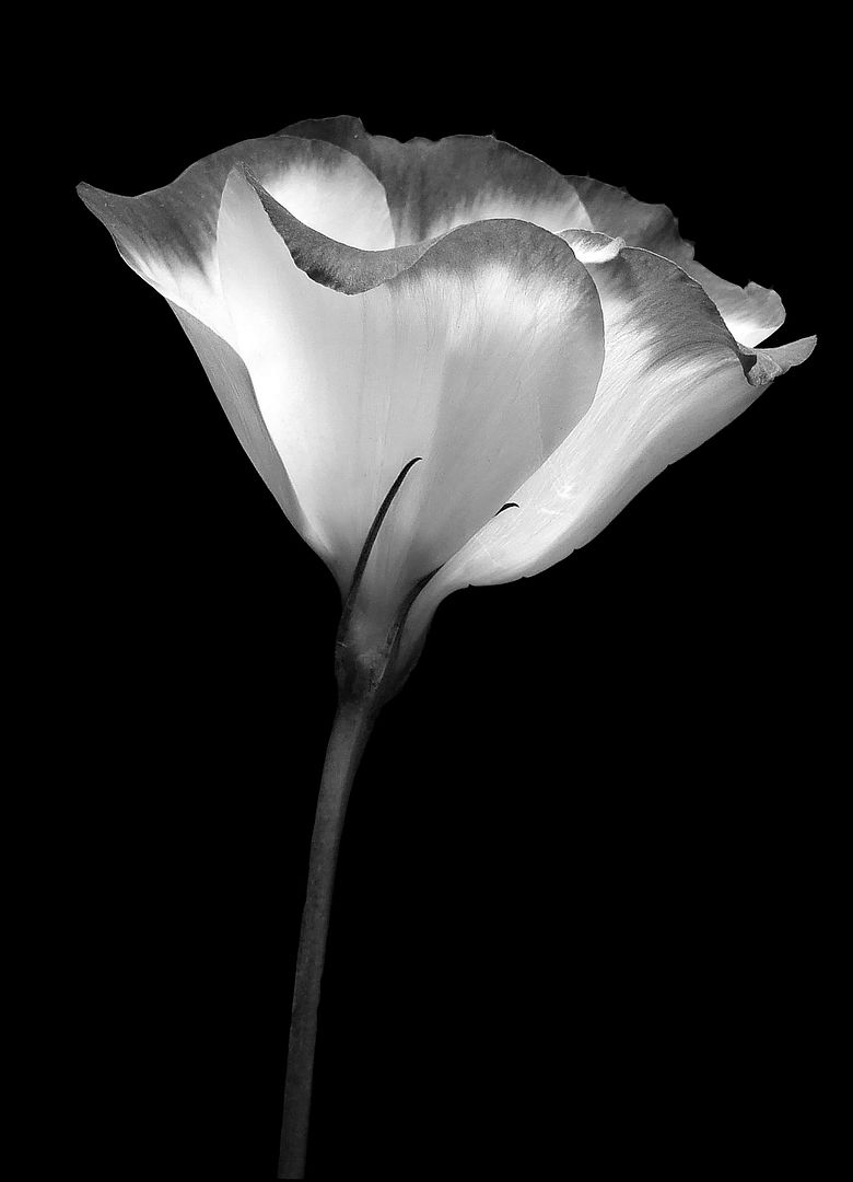

ok ive just bought a Canon MP 520 and im having a spot of trouble with photo printing.

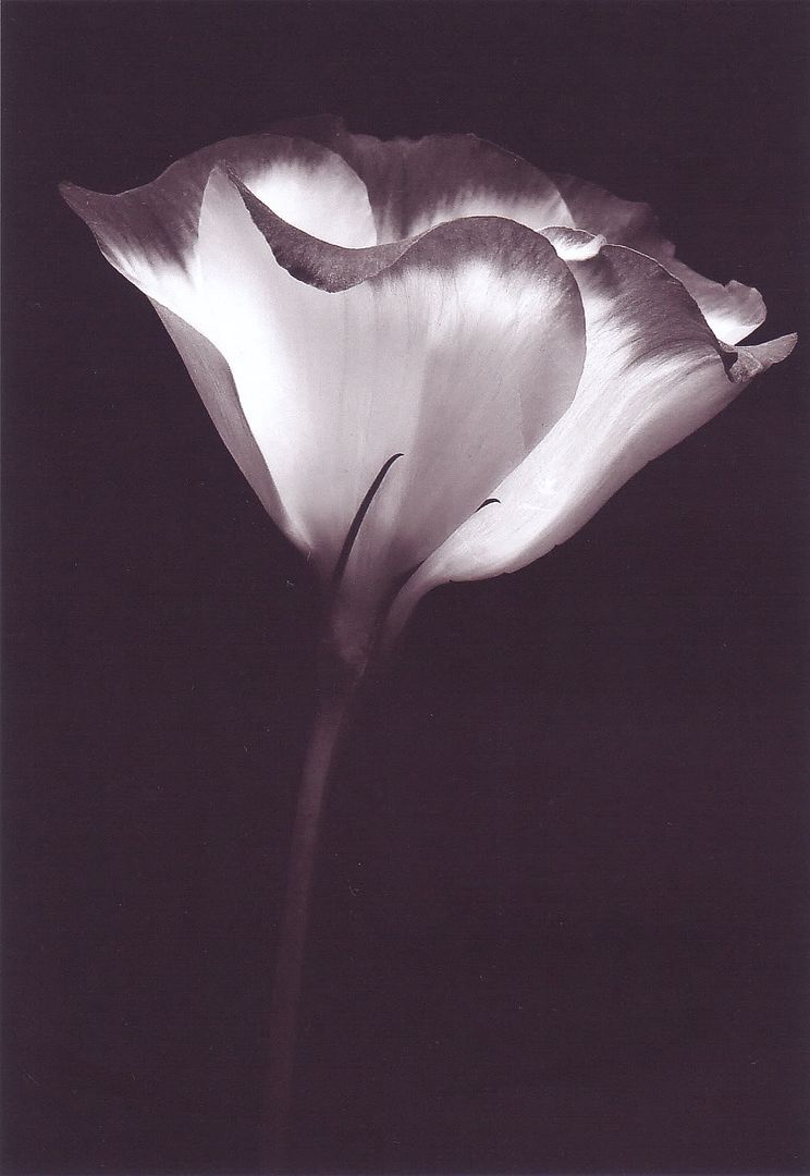

Basically ive downloaded some nice black and white pics that id my girlfriend wants to frame and stick on the wall but when i print them out they look slightly sepia instead of black and white, even when i choose greyscale to print the photos.
This is driving me mad and ive already used a box of photo paper and my inks getting hammered aswell, please please can somone help i just want to be able to print out the photos as they were intended.
original pic is Jpeg 1488x2061

Original Pic
Pic after printing

Greyscale uses magenta as well as black ink. If your driver doesn't have a B&W option, you're probably out of luck.
Also - is your monitor calibrated? It may be printing correctly after all.

Ive added the pics now if you want to see, its terrible compared to the original.
i havent seen an option for black and white only grayscale.

ive just done a small post card size and it looks purple, do you need special photo paper for black and white photos, ive just put my photo paper next to my normal every day paper and the photo paper looks like an off white compared to the normal A4 paper.
here look
Printed with colour option

i think its the paper that causing this, i did a print on my everyday paper ( not photo paper ) and the colours were correct, black was black and white was white like the original picture but obviously looked naff cos it wasnt photo quality paper, so my next question is, can you get WHITE photo paper instead of off white? i have some matt photo paper and that is also an off white and gives the same sepia results when trying to print B&W photos, i have also just wasted the 3 colour inks and my black is still 3/4's full :(

ok i printed the photo on my nextdoors printer and it came out perfect and looked exactly like the original, im uninstalling anything that is canon from my pc and im going to install it all again. i hope i can fix this as im not impressed.
