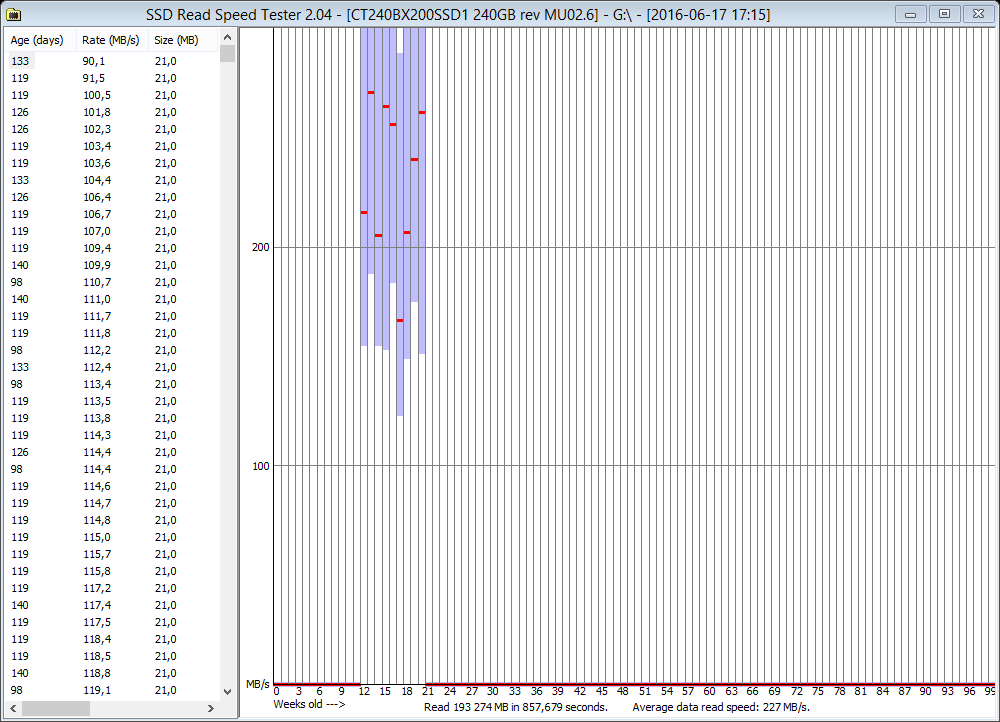

Just a bit late to update compared to the last time.
Results of last test:
Read speeds continue to drop but haven't changed that much compared to last time.
