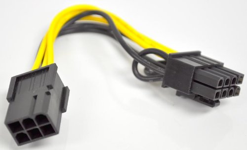

Hi guys, I just bought an MSI GTX 1070 and my current power supply is a Seasonic SS-430B. The GTX 1070 has one 6pin socket and one 8pin socket, see image below.
However my Seasonic power supply has 2pcs. 6-pin PCI-E connector, an extra 1pc. 4-PIN and an 8-PIN connector for the motherboard only.
My question can my power supply be used with the GTX 1070? If yes how can we use the extra 6-pin connector?
Thanks in advance for any replies.

There are adapters that go from 4-pin Molex to 8-pin PCIe power, and also from 6-pin to 8-pin PCIe. If one wasn't included in your GPU bundle, you'll need to locate one. A 430W PSU, even a Seasonic, is a bit small for a PC with a big GTX 1070, generally speaking. It's probably okay, but you don't have a lot of safety margin.

Hi crashtech, thank you for the reply, yes I am considering the 6-pin to 8-pin adapter but I believe the PSU or the graphics card should have those adapters or the plus 2-pin in the PSU at least but I don't have those, I might as well buy one.
I have checked and my Seasonic SS-430B is compatible and can run the GTX 1070 in normal use, I don't have any plans in overclocking, btw, I have a mini-ITX build an an i7-7700 CPU plus 3pcs. SSD's

Also, guys, can I just insert the extra 6-pin to the 8-pin in the GTX 1070? so basically, I am attaching two 6-pin connector from the PSU into the 6-pin and 8-pin of the GTX 1070 respectively, it seems the 6-pin fits the 8-pin. Although I will not try this until I confirm it is safe.
Or what is safer with the option suggested by crashtech:
1. 4-pin molex to 8-pin PCIe power
or
2. 6-pin to 8-pin PCIe conector

The GPU probably has a circuit that will detect the missing grounds if you try to only insert the 6-pin connector into the 8-pin spot. This circuit will prevent the GPU from running. Some kind of adapter is surely necessary, unless you want to rig something to ground the extra pins, which is not recommended.

Thanks again, I have now an 6-pin to 8-pin adapter and will test later. As for what you mentioned on "safety margin" what are the things to consider here given that I have a Seasonic with 430 watts?

I am partly considering getting a new PSU aside from the power output but also from the modularity of newer ones but I wont be able to buy one in the next few weeks or months. However as for my current PSU, I would like to know which is the safer choice for me to use for the 1070 in the short term.
1. 4-pin molex to 8-pin connector adapter + native 6-pin power connector
or
2. 6-pin to 8-pin connector adapter + native 6-pin power connector
or
3. two 6-pin to 8-pin connector adapter + 4-pin molex to 6-pin connector adapter
Oct 13, 2014
30
5
plus.google.com
or
or
Option 2, one 6pin and one 6pin to 8pin adapter, your power supply will be fine

Thanks! I but what is the difference between the two in terms of power delivery? And can I use the dual 6-pin to 8-pin as a replacement for the 6-pin to 8-pin? it seems that the wire configuration is the same.
1. 6-pin to 8-pin connector adapter
2. Dual 6-pin to 8-pin connector adapter
Since you have only two 6pin connections from your power supply, option 1. is it. Power draw will be determined by GPU bios and whether you over clock. You just need to make sure that your power supply can provide enough, and it should.
Wall Street
Mar 28, 2012
691
44
If you use the dual 6-pin to 8-pin, make sure that your PSU doesn't have multiple 12 volt rails.
What I would do is first see if you can just plug the 6-pin into the 8-pin and get it to work. Sometimes on those card it will not actually sense if the other two pins are present. This is better than using any adapter.
Fallback option would be to use the single 6-pin to 8-pin adapter.
In terms of power delivery, the dual 6-pin to 8-pin should be better if your 6-pin connectors have very small gauge wire, but otherwise won't do much. If you use the dual 6-pin to 8-pin connector, what will you plug into the 6-pin socket?
The reason this PSU doesn't have an 8-pin connector is that the wattage is so low. You are right that your card doesn't need an 8-pin, but with the PSU, I would not overclock your CPU or raise the GPU power target.
