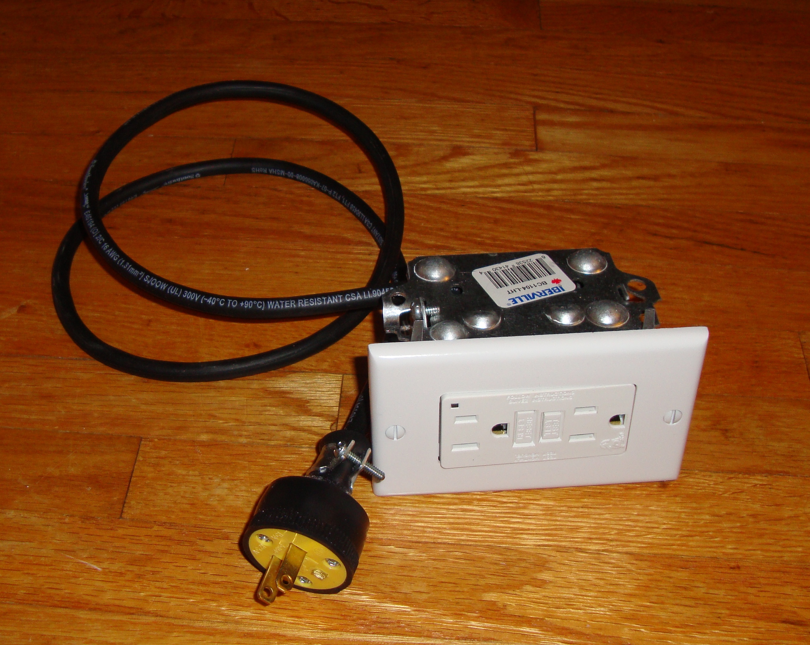

I would demand that they fix the outlets. It's crazy there are places that refuse to update to current code,I'm not talking about the silly codes like how a kitchen needs 2 20 amp circuits, but the important ones, like proper wire sizing and need for earth ground.
If that really can't be done, I would make an adapter using a GFCI outlet, something like this:
If there is any leakage current through the ground pin, it will trip the outlet.
I actually use that for Christmas stuff, since timers only have 2 prongs and I usually plug all the lights in a power bar, and all of those are 2 prong anyway but the power bar is not.

i guess i have to try that gfci thing. Red squirrel, did u buy that thing or u made that urself?
Harvey, i don't have them online so i can't upload them:\
I made it, basically extension cord wire, plug end, wiring box, outlet and plate. Black to hot at both ends, and white to neutral at both ends. Neutral is the thicker blade.
For more permanent use, I'd also build a small wood frame around it so it can sit nicely on the floor.

Thank you guys for your help.:) I'll see if I can make one like Red Squirrel's gfci outlet.
